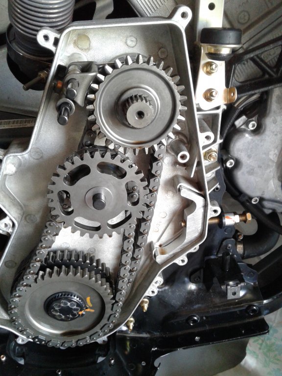

How do I get that chain tensioner back in the case with everything installed? I had the screws tacked but I am wondering how to install, any tips? Thanks in advance.
Back off the tension screw, push chain over and install tensioner on post.

yeah back off adjuster a bunch, slide it back on. Be sure to get the spring in correctly...

Ok, I figured that. I just was having difficulty with the spring pushing the small end down to rest against the case. Any tricks there?

A small flat head screw driver works good for meOk, I figured that. I just was having difficulty with the spring pushing the small end down to rest against the case. Any tricks there?

Mine went on easy once I had the spring tang held into position. Maybe a screwdriver or something if needed. Pretty straightforward I recall.Ok, I figured that. I just was having difficulty with the spring pushing the small end down to rest against the case. Any tricks there?

Take a small dia 1/4" drive deep socket with a screw driver handle on it. Put the socket on the end of the spring and lever/guide it into place. Then the socket slides off the end.
Its a bugger but that worked for me.

Thanks for everyone's help, she's in place and buttoned up.

Servicing a 19 SRX with 4300 kms. The bolts did not appear loose but when I put a socket on the bolt they were in fact slightly loose. Both sides which would allow the center shaft to spin. I wonder if that contributes to them coming loose further(the shaft spinning).

IMO, if the shaft (axle) did spin, since the it would be turning counter-clockwise, that would have a tendency to tighten the outside screw but loosen the inside screw. No matter, another example that many/most of these tensioners have loose screws. Ugh!
