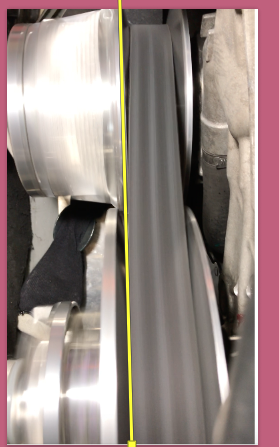

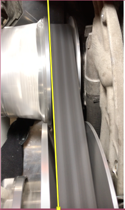

Maybe this helps?I don't see the difference between video 1 and 4? Is the belt bending......hence you removed some material to push it closer to the frame?
Wrong offset

Superturbo, that helps trememdously, as now I see what you are referring to.....sorry to be a retard, but I have a belt eater and would like to find a cure.
Let' discuss the fix: It appears as though adding shims behind the secondary to push it out or away from the frame would better line up the clutches. However from reading your post, you removed material and essentially pushed the secondary clutch in or closer to the frame. Can you clarify this?
Lastly, what if a guy machined 5mm off the inner hub of the secondary and re-installed without any shims. Or added shims under secondary clutch bolt if secondary needed to go out. Would the clutch float and take it's place on its own?? Thanks.

Opppsite, secondary needs to move further inward than simply removing shims would allow, which is why he removed material from the secondary shaft.

Or the primary is too far inward for whatever reason (machining or taper issue)..
....this is why I said reinstall the oem primary as per spec's and lets see the same demo...assuming the results were the same...
lets examine possible solutions...
If all shims are removed and the clutch is sitting against the bearing...could the bearings inner race ( $20 bearing) be out of spec where another bearing gains you .100 or could the bearing pocket be machined off or have something in it that is pushing the bearing slightly out?
since the motor mounts are not adjustable... and if both clutches net the same....I would look into the crank stub shaft assembly ...again...bearings and splines to splines ....
Definitely some possibilities SJ. I too will be removing my belt guard and looking into this after the holidays. At least Superturbo has lead us into possibly developing a path forward in curing these belt shredders.
