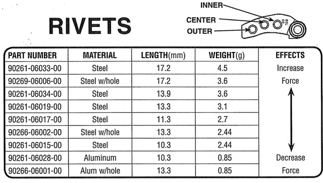

Removed clutch tonight after work to double check my work, clutch moves freely, weights move freely, spring is set in helix, went out for a ride and same results, beginning to wonder if the rivets I ordered weren't correct
90269-06006-00?
90269-06006-00?

http://www.totallyamaha.com/snowmobiles/aaTECH/drivespecs/Rivets_Rollers.htm

Its always been in TY Tech:
90269-06006-00?
Ok, just getting back to posting here (sorry guys....been sick all week with flu, bronchitis and pneumonia )
Something to look at since you posted your rivet part number....because the length is longer than the 13.9 length rivet I use....check to see that the weight with rivet are not hanging up inside the spider (check for marks of scraping or rubbing) The rivet should not extend more than 1/8" of each side of the weight....so that is something to check.

Everything looks fine, ordering the 4.7 weights, at 92 mph it's hitting the rev limiterOk, just getting back to posting here (sorry guys....been sick all week with flu, bronchitis and pneumonia )
