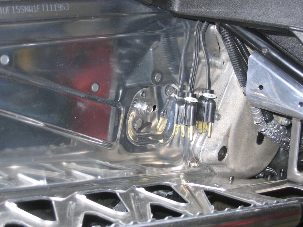

I can see that y0u never really installed these heaters, just speculating. Installing 2 Katt's 26050 pad heaters, one on the right side of the pan and one on the front left side of the block will start the sled in any cold condition. I have installed these on my new XF7000LXR and NEVER had a cold start issue , EVER. As long as there is a 120 volt outlet around. Somewhere around -15 deg C is when the heaters are needed.
The idea is NOT to heat the oil, or the coolant. The idea is to put heat into the aluminum block so the oil in the main and balance shaft bearings is not like maple syrup when you crank it. If you don't think this is enough heat to do the job, then you must live in Antarctica.
Spend the money. Install the heaters and ride.

Yea you are speculating. The sled will probably start with just the heater on the block. The one on the pan is for the other side of the engine since I could get one on the right side because there was no smooth area.
What is real funny is how this sled and two others fitted with the same heaters start the first try when sitting outside in Kirkland Lake, Timmins, Cochrane, Kapikasing, Hearst and Amos PQ. -34Cor not. Oh and BTW the original battery is still in my sled.
If you like fiddling around with the seat and booster boxes, then you go for it. I just roil up my cord, put it in my touring bag and ride. I LMAO watching Sidewinders getting ripped apart in motel parking lots with booster boxes and box heaters and hair dryers all around. I guess some people will never listen.

The heater on the oil tank is pretty much useless IMO. Like I said above, heat the engine casting, not the oil. Don't use a coolant heater or the warm coolant temp sensor will stop the cold start routine. Get two Kat's 26050 50 watt heaters and install as per my pictures. Make sure the casting is smooth. Clean it up with a die grinder and Scotch Brite disk if you have to. Run the cords out the right foot well. Get a 4 or 5 meter extension cord with a 3 outlet female end with a light inside so you know the outlet works. Get a 2 - 3 meter cord with light and 3 tap end to jumper over to your buddy's sled. We have daisy chained 3 sleds together already. In Northern Ontario, every motel has outlets outside for diesel trucks and cars block heaters.
I bought a small boost box but never used it yet. Why would I submit my starter, and fragile gears to extra torque when the sled can start like a normal warm start ? If you do what I tell you, you will never have a cold start problem period. When not needed, you can push the cords up over the round tube so they are out of the way of your foot.

Sorry, I am new to the 4 stroke world. So I should take the heater off of the reservoir and install it as per your pictures.
Thanks, I have all summer to rig up
Big Pussy
- Apr 12, 2016
- 95
- 73
- 453
- Woodstock, Ont
- 2015 XF7000 LXR
You can leave it there but it won't help you. If you rip it off, it probably won't stick again.

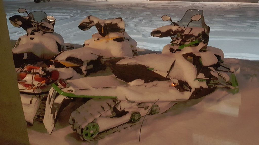

Here is a picture of a Thursday morning in Kirkland Lake this winter. -29C morning and both sleds started on the first try. A lot of dusting was required first though. Note the pilot light on the extension cord end. The Skippy-Doo in the middle needed a hair dryer to warm it up enough to pull the engine over with office arms. Its not just the 4-strokes that have problems. The trick is to make your trip as reliable and effortless as possible. They were plugged in all night. There is no extra charge for the power so its a free start.
