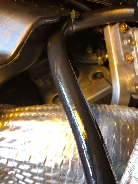

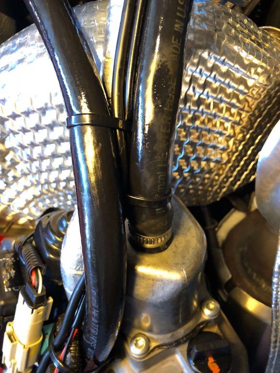

Why do you think there is so much oil going through the hose? Do you think this system needs a little back pressure to keep too much oil from blowing out?weird....
Just decided to check mine, and its got a light coat on it like Mikes..
I dont get it....I check it every day and its dry, and now Mike posts this and I go look at mine and it looks like its wet. Not leaking but wet look....
Its like it must take certain amt of time.
Looks like I need some made for fuel/oil.

Joe, the coolant hose breaks down with TIME from oil/fuel. Had a good talk with a smart fella at a reputable auto parts store.....Told him about what happened and he told me before I could finish, coolant line will break down in time from fuel/oil or any petroleum product.Why do you think there is so much oil going through the hose? Do you think this system needs a little back pressure to keep too much oil from blowing out?
I really hate this design and Yamacat needs to come out with something better than what they give us.
So he said he will order me 4 feet of fuel line, its a neoprene material. I asked about heat and he said it will do fine. But I will withhold judgement on that til I have it in my hand. I want to feel it.
Looking at stock sled.....grab the original oil tank to ROV hose....its heavy duty(made for heat). Now grab the smaller oil line from ROV to Intake, its a much less substantial material. Both obviously work with petroleum products but one is alot tougher. Im hoping the stuff he ordered me is the tougher stuff like origin piece from tank to ROV. If not I will order the better stuff.
While its hot there, I dont think its hot enough to melt any rubber type hoses(except vinyl) as long as you are an inch or more away from shield. The shield is not hot like the muffler/header itself. Its thin. But will see how it goes when the 10 dollar hose arrives.
By far cheapest mod for ROV issue and keeps the crud out of turbo. The weird thing is I looked at the original 3/8 line I had when I did the first TEE design(when i was riding next day in minus 30) and needed a quick fix. And that orig 3/8 line I had bought says fuel line on side...lol Got the new 1/2" line from same bin in store, and did not even notice diff in feel.....but saw it said coolant after installed, and thought to myself, " I wonder if this is OK for oil".....grrrr
