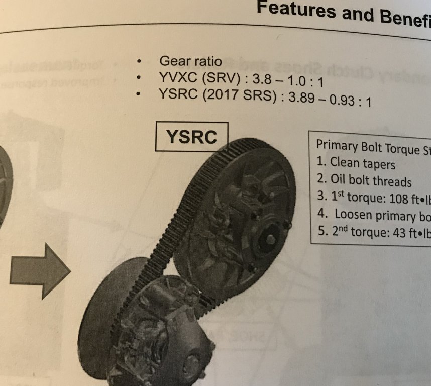

Doowithblue
- Mar 17, 2016
- 865
- 568
- 1,038
- Waterloo ON
- 07 Mach z x (sold)
18- RTX LE
That's great if you are not having roller issues, consider yourself lucky there. What are you running for RPM? I wonder if perhaps its a RPM harmonic thing happening. I can't imagine any of them are that far off though.
8850. I may try backing off secondary tension tomorrow and see if it still grips the 825. Seems too good to touch anything but we'll see.

Those Ratio figures are accurate if you allow the secondary to Coil bind on the old button clutch the way it came from the factory, but if you fix the coil bind on the secondary of the old button clutch and allow the secondary to travel fully you end up with the same ratio as the winder.
