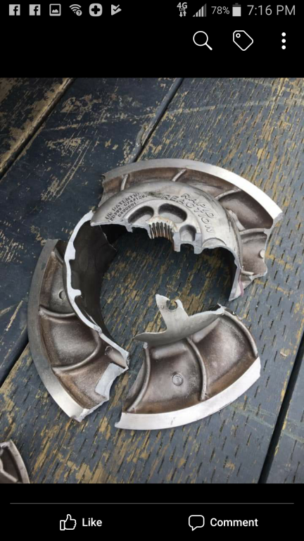

Yikes...that's a bad day. I'm curious as to the specifics...tune, mileage, etcView attachment 143442 View attachment 143443 View attachment 143444the team clutches have been exploding too. They pop up on some of the Facebook sw/tcat groups here and there but usually get taken down quickly where the exploded yamaha clutches are allowed to stay posted.

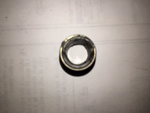

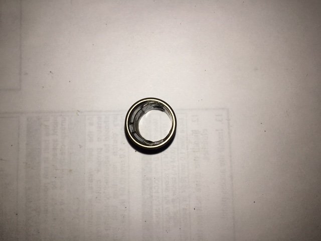

First ride of the season yesterday, got to do some long pulls on hero snow. RPM wasn't right and could only pull 125 on GPS. Pulled rollers out when I got home and they are starting to show signs of wear...

Hi laker, what is the mileage on those?

LOL. Signs of wear? You mean completely destroyed.

Wow Jim, those looks toasted! Not a ton of miles if I recall?....
This big power sure is tough on clutches and components.

Just over 1600 miles.

Grrr....not many miles, but at 270hp maybe that is as good as we can expect? Wonder if the TPs will last me much longer?Just over 1600 miles.

Who knows, getting pretty tired of this. Yes, it is a good engine, but there are far too many decisions on this sled that were made by the accounting department as opposed to the engineering department. The build quality is substandard, and as the years/miles start growing it’s just going to get worse.
The sidewinder is a YINO (Yamaha in name only). Might keep it for another season, but it’s days are numbered.
