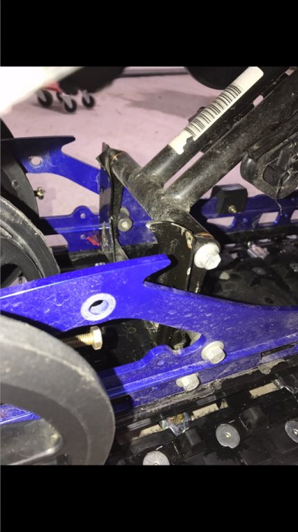

So after going back and reading last years thread "Removing Transfer Blocks" ( https://ty4stroke.com/threads/removing-transfer-blocks.145776/ ) sure enough, moving the scissors to the foward holes was done.
Whether it was done intentionally or set up that way from the dealer. Just so happens it was the member that pulled the shaft out and rim racked his big wheel kit in the process. My guess is he didn't get much seat time in before this happened , but who knows? Maybe Winder1987 can add some more insight on the matter.

There are no forward holes.So after going back and reading last years thread "Removing Transfer Blocks" ( https://ty4stroke.com/threads/removing-transfer-blocks.145776/ ) sure enough, moving the scissors to the foward holes was done. View attachment 134037 Whether it was done intentionally or set up that way from the dealer. Just so happens it was the member that pulled the shaft out and rim racked his big wheel kit in the process. My guess is he didn't get much seat time in before this happened , but who knows? Maybe Winder1987 can add some more insight on the matter.

I can’t see why people remove the coupler arm. It defeats the purpose of this suspension. Buy the 141 if you want uncoupled, it’s basically the same length.So after going back and reading last years thread "Removing Transfer Blocks" ( https://ty4stroke.com/threads/removing-transfer-blocks.145776/ ) sure enough, moving the scissors to the foward holes was done. View attachment 134037 Whether it was done intentionally or set up that way from the dealer. Just so happens it was the member that pulled the shaft out and rim racked his big wheel kit in the process. My guess is he didn't get much seat time in before this happened , but who knows? Maybe Winder1987 can add some more insight on the matter.
not only defeats that but weakens the skid as well....

Its interesting to go back and read the thread from last year.
Nobody posted about moving the scissor mount forward but some moved the coupler limit shaft back in the skid - 1 so much he added material to the top of the tab to hit the blocks.
Lighter factory springs or modding (shaving down) the coupler blocks is probably the best answer.
