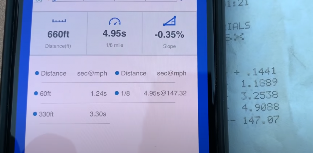

In the above comparison between dragy and a timeslip you can see that the draggy is off about 5/100ths of a second through 330 and its off by nearly 3/10ths of a second over the run. In a games of hundredths and thousandths how accurate is accurate.

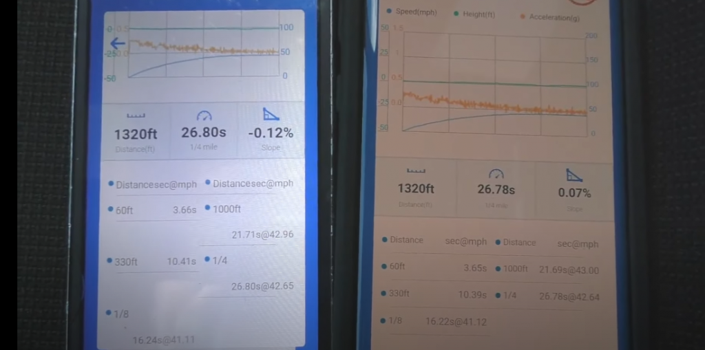

Screen grab from youtube video comparing two dragy units that were mounted side by side. Again, accurate enough for the internet but not accurate enough for meaningful race results.
