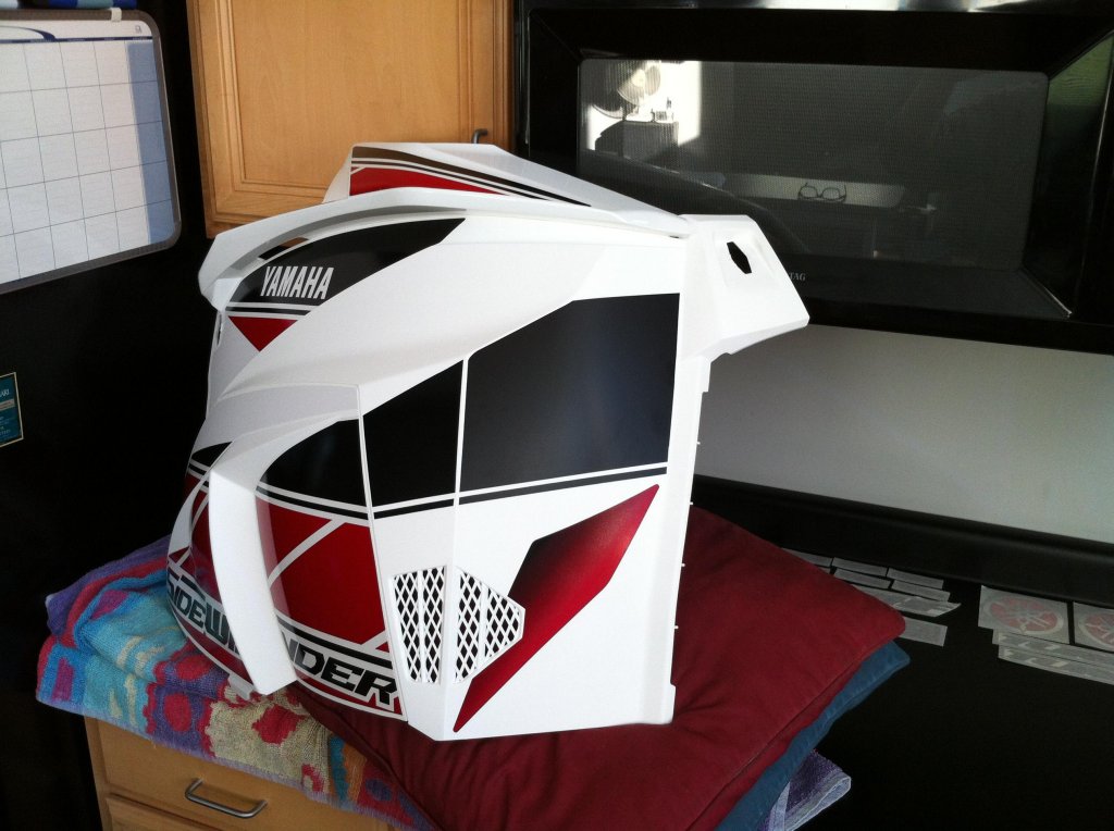

I love the 50th graphic design, but the white panels at the knee area sure will be tough to keep clean. I also felt the graphics could have gone further back around to knee area. So I wanted to do something here, yet keep it very 50th looking overall. I don't mind some wraps but most the time I don't like many of them. And its tough to get anyone to just work with you on just one area around knees. So I ended up doing it all myself.
I had the idea of what I wanted....and so I just did it old school, like I have done many sleds back in the day. Using vinyl and hand-cutting each piece to size, fitting them to the sections I wanted to do.
With these plastics its nice and easy to bring them inside, get them up high where you can work on them close up. Using 91% alcohol to wipe down the surface for prep, and then apply.
Some pics of the process......
Graphics/Wrap- Knee area
View attachment 131924 View attachment 131925 View attachment 131926 View attachment 131927 View attachment 131928 View attachment 131929 View attachment 131930 View attachment 131931 View attachment 131932 View attachment 131933 View attachment 131934 View attachment 131935 View attachment 131936 View attachment 131937 View attachment 131938 View attachment 131939
