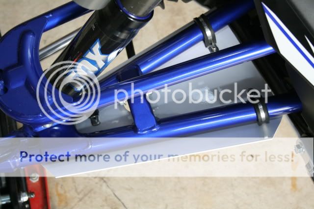

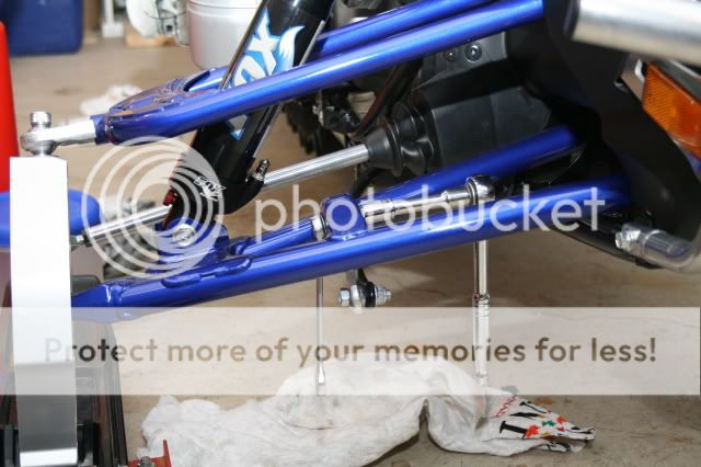

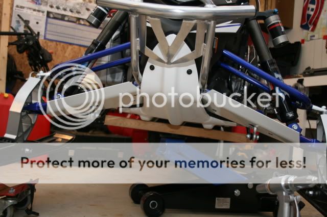

A-arm protectors install
Got these from http://www.muffinworksltd.com/ I wanted white so I did a search here and found these guys.
Yamaha doesn't offer white. Hmmm...
These should help out with flotation. Kit comes with all stainless steel hardware needed to do the job. Fairly simple install.
Remove bolt and nut going through stabilizer joint on both sides holding up sway bar.
Let sway bar hang down. Put the plate in place and feed stabilizer through the hole and install bolt again. This will need a 24 ft.lb torque setting.
Feed the rivet up through the already predrilled holes(three per side) and use the supplied hardware to install. You will need a buddy for this step to hold the washer tight to hold rivet. I also used a clamp to help line everything up.
Piece a cake.

Yes it is. My plan was to go blue but all the blues didn't match with the machine so I went white. I ride in some deep stuff here on the West Coast of Newfoundland so I went with the 1.5". Thought it would be a good compromise for me. I wouldn't mind taking your set up in the hills either. Keep us posted.

I really like the looks of this but is there any worry of these while acting like float plates also acting like a shovel and allowing snow and ice build up eventually adding wieght to the lower arm and affecting the suspension?  Don't blast me for asking a stupid question just asking.  Could be way off base.

I think you'll go airborne at 70 mph thus eliminating any concern about slider wear.
