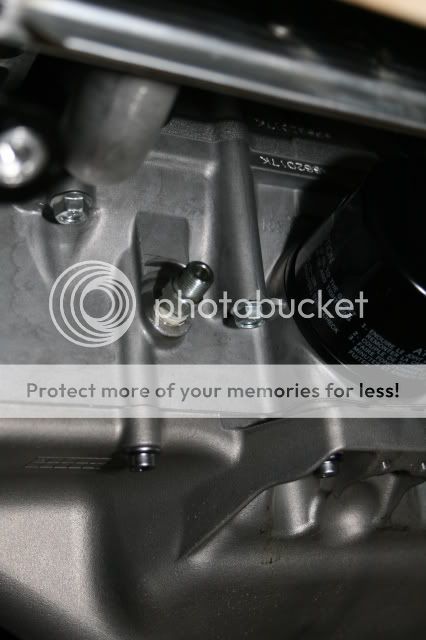

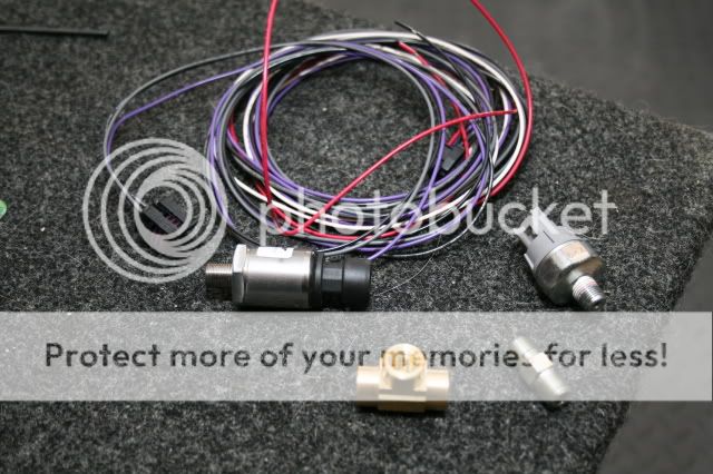

Here is my OIL PRESSURE GAUGE INSTALL
Here is my gauge. This is a full sweep and should be able to give me an accurate reading of psi. For the Nytro it is 7.3 psi @ 1400 rpm. This is basically at idle so it will increase with rpm's.
Now I had to find where the sensor(Oil pressure switch) was and it is located to the left, beside the oil filter. I took off the protector and there it is.
Disconnect coupler and unscrew the sensor. A small bit of oil will come out.
This is what I am using to install. I have a copper Tee and a heavy duty hydraulic 1\8" NPT close nipple.
Screw in nipple and use pipe thread sealant(keep first couple threads clean). I used Pro-Dope. Don't over tighten.
Screw on Tee and install the sensors using sealant of course. It is a really tight spot. This is the only way I could make it fit.
Now I installed my gauge holder and running the wires. I hooked up the ground to bolt on frame and I'm getting power this time from the 12 volt Dc Plug. I used Polyethylene split loom to case wires, gives a little protection from the elements and helps clean up the wiring.
