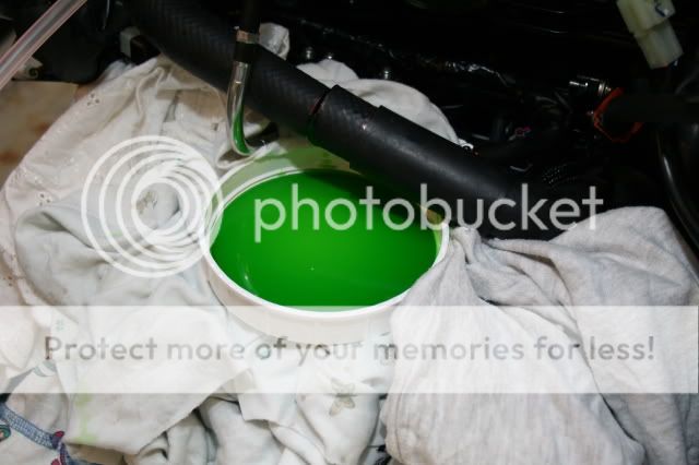

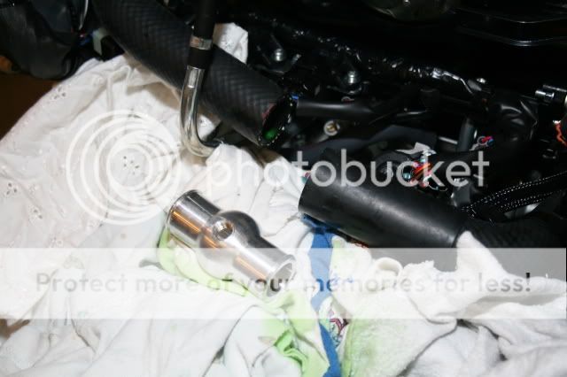

First I took out as much antifreeze out of the tank as possible. You will still waste some so use lots of rags.
I caught a lot in a small cover. Mark off a 1" wide area where
you plan to install the hose splice adapter. I used a marker.
Go ahead and cut slowly. Used a olfa knife for this.

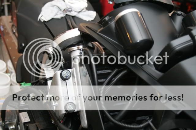

Oh, I got the hose splice from http://www.ulmerracing.com/
Here is a pic of it as ordered.
It also comes with clamps.

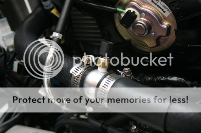

Next, install hose splice adaptor. Tighten the clamps.
Next, I installed the temperature sender that came with the gauge.
Make sure you use tephlon tape on threads. Don't want leaks.

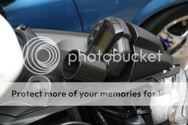

Next, I installed my 2 1/16" gauge holder.
This also came from Ulmer Racing.
Just what I was looking for and comes with different mounts. So you
can use what works best for you.
They are quite adjustable.

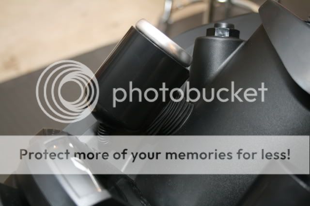

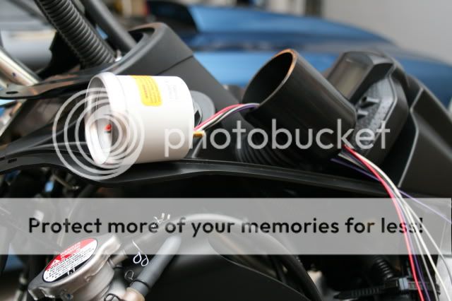

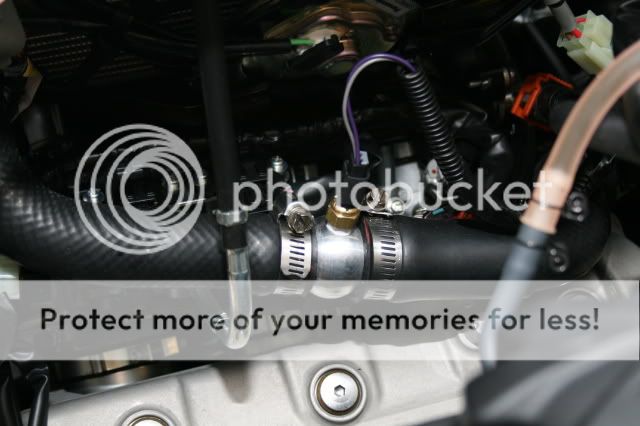

Time to run the wires.Put gauge in holder and tighten. Wires connects to back of gauge.
Connect wires into sender on the hose splice.
Now, ground wire from gauge goes bolted on the frame.
And I am splicing the red and white together from gauge
and going to the Blue/White wire in fuse box.

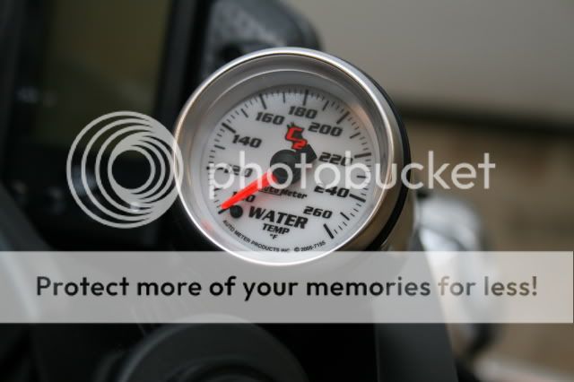

Pics of Autometer temp gauge installed.
