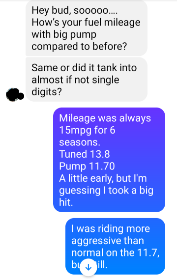

I've installed a big pump recently, as well as another member on Ty.
I do not have CL or data logging, adj. Fpr, he does. Both of us lost MPG of about 2mpg.
Unfortunately, my short ride of 85miles was heavy on/off throttle. (That's not how I normally ride) my afr was 11.9 to 12.5 which I assume is typical.
He could possibly have a bad O2 sensor?!?! He's looking into it now. He's watching the "poor fuel mileage" thread here.
Just coincidence?!?! Idk. Just letting you know. He is not the type that likes to air dirty laundry.. I can make a copy of all of his Cl, adj. Fpr, etc statements but I think you get the drift. No need to drag others in any further . View attachment 175272
I highly doubt the O2 sensor is at fault, in fact I would guarantee it's the hi-flow fuel pump making for a fuel thirsty machine. Depending on the size of the pump installed, It a fact that the stock fuel regulator can't handle the flow, the pressure is rising and is tanking the fuel mileage. So you put up with it or do a fuel regulator. Just putting in a hi-flow pump is not the right thing to do if you want it done correctly, the regulator needs dealt with for the added flow if the pump is big enough to override the stock regulator. The stock regulator is a bottleneck with a big pump.

And yes, that Walbro GSS342 is starving for fuel, or so it would seem. Neither of us thought it could be so thirsty, for the simple fact the computers trying to keep things within a set parameter?!?!

Doc, there was no way you would get better fuel economy with the addition of the bigger pump alone. The tunes are running on the rich side to begin with and that was only going to exacerbate the situation. It's very simple, if you saw lower AFR's after the install you were running even richer burning more fuel. The added fuel is to stave off detonation and timing being pulled. I ran the AFPR and BIG pump on the stock tune before flashing and noticed I had to increase fuel to keep AFR's in check and they were very consistent in the mid 12's. It wasn't until I ran the flash which activated closed loop when I could see live as well as the DATA log the AFR's and what closed loop was doing. Then I could see it was pulling fuel and allowing AFR's to climb when cruising, ei: the 60 MPH trail ride. Now we're saving fuel and running efficiently as it was intended.
