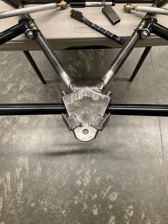

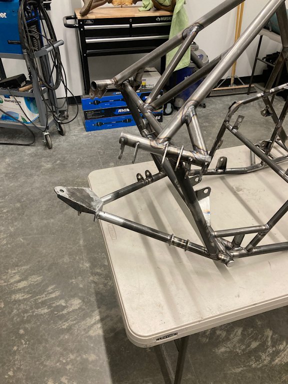

After thinking about it last night every solution I could come up with seemed more complicated, time consuming and heavier then just cutting out the tubes and redoing them. Took me about 2 hours but I got both 1” tubes out and the welds ground smooth. It’s not all bad, the tubes were in the way of the nuts before so I had to weld turned down nuts to the frame which I wasn’t a fan of. After I redo the tubes I’ll have all the tie rod clearance I need and can use regular nuts on the bolts.
Going to put the front suspension back on and figure out the tube location then put it in the jig before welding.

No better time to fix it right, otherwise it’s going to drive you crazy, after you get it all together & its not to your satisfaction( I know it would me)kudos for taking the extra time to get it right, you will be much happier & can proceed to the next step,besides for us that weld its just more practiceNo I did not but I had bent tie rods on my last build and wasn’t a fan.

Since my new tubes will tie in further back I decided to reinforce the lower tube/a-arm mount with a piece of 1” tube. With that done I will reinstall suspension and fit the upright tubes.
