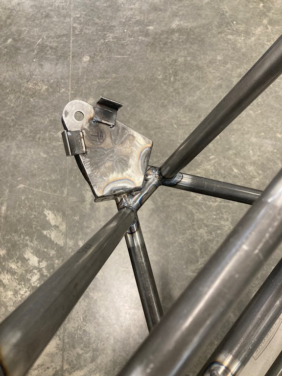

I realized I was getting complacent with my weight loss when every gram counts in this build. I ground out the gussets that my 1” pyramid tubes welded too. They didn’t need to be nearly as big as I originally made them but I wasn’t sure where the 1” tube was going to hit so I made them big to start with.

Went back and forth between using .090 plate or 1x1/2x.035 rectangle for the gusset. The rectangle gave 3” of weld vs 2” on the gusset and I figured rectangle would be less likely to tear away in tension. Weight was the same for both. I would do the front a little different next time so the tube work didn’t look funky.
