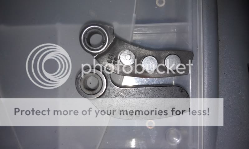

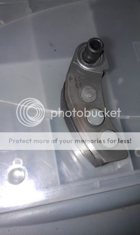

I also changed out the weights to a set of Dalton DTYA2's.
The profile isn't a whole bunch different than stock, though more smooth on the mid and a bit more aggressive on the tip.

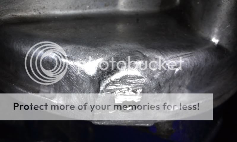

First repair job was welding up a chaincase from a Summit. The owner hit something an mashed a panel rivet through the bottom of the case.
Cracked;

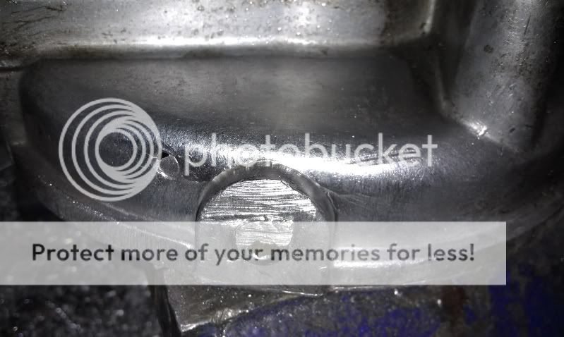

Despite being cast, I took my swing at welding it. For those that don't know, cast is a real pain to weld due to the impurities in the metal during the pour. I put to use everything I ever learned about aluminum on this job. I cleaned the area up good with a buff pad, and took the acetone to it for the final clean.. I then hit it with the MAPP gas for about a minute to burn off any residual oils and to push the heat into the base material.
As soon as I lit up on it, I knew I was in for some interesting work. The casting would pop and spark like it was laced with steel particles, and wouldn't puddle nice. I ended up making a light pass over it with light current to do some 'AC cleaning'. Once the material was hot and clean, I made mini puddles around the crack and set in some small 5356 mig wire I had sitting around to get a better base. Once I had something that was actually weldable, I took to it with some 4043 for a real penetrating pass. It welded up way better with the base on it. For reference, 5356 is typically an easier filler to weld with, but isn't as strong as 4043 in extreme temperatures. For this reason, I prefer to use 4043 in all of my snowmobile welding.
Fixed;

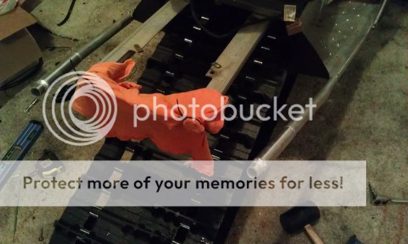

Here I have the panels off, and the rear exchanger removed.

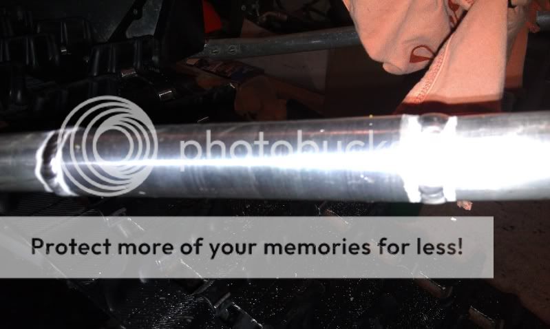

Monday, I picked up some 1" pipe and machined the OD down to match the existing grab bar. The extension will be hidden behind the panels, but I still wanted it to match. I then machined some inserts so there is some extra material
around the joint.

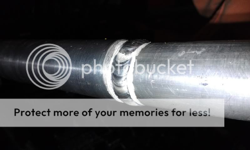

All welded up.
A few shots of the welds.

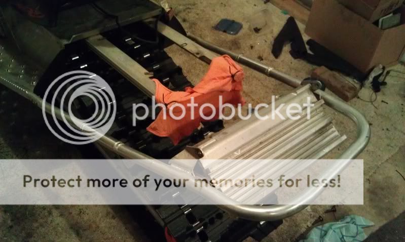

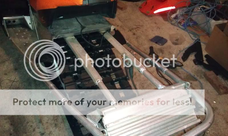

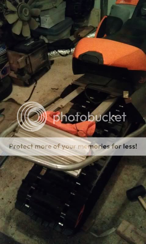

Last night I worked on the exchanger extension.
The coolers and the grab bar are at different angles, so I had to get creative. I ended up rotating the rear cooler, to give more clearance from the track. I then took some 3/4" pipe and put a 30* bend in it, and cut the bend in half. The extension is 6" long, then tweaks up 15* to meet the rear cooler.
I had some issues with final closure weld (my own fault). I welded the top first, then did the bottom, forgetting that I'd be resealing the system. As soon as I tried to close the system, the remaining glycol in the cooling lines would try to vent off. I ended up having to drill a relief hole in one of the top welds, close the bottom, then reseal the top after the material cooled.

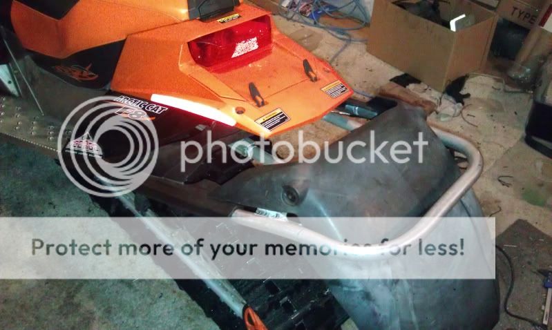

For tonight... figure out what I'm going to do to fill the 6" hole in the top of the tunnel now.
Cracked;
Fixed;
around the joint.
All welded up.

After pondering on how to fill the hole, I came up empty. I'm handy with metal, but aluminum just doesn't finish the sled well, considering all the plastic.
The owner came by, and had said he'd tinker with it at home. He mentioned using a piece of mudflap and a backer plate, then rivet it to the stock snowflap. Pretty good thinking there.
Here is how it sits now;

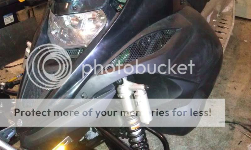

I finally remembered to snap a finished picture of the Nytro.
Not really much has changed. I went to a spring tensioner instead of the threaded unit. It seems to hold the belt better over the rev range.
I'm still second guessing the intercooler filler location. It is kind of a pain to fill, although since being filled there hasn't been a reason to open it again.
