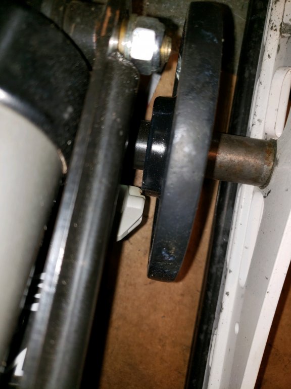

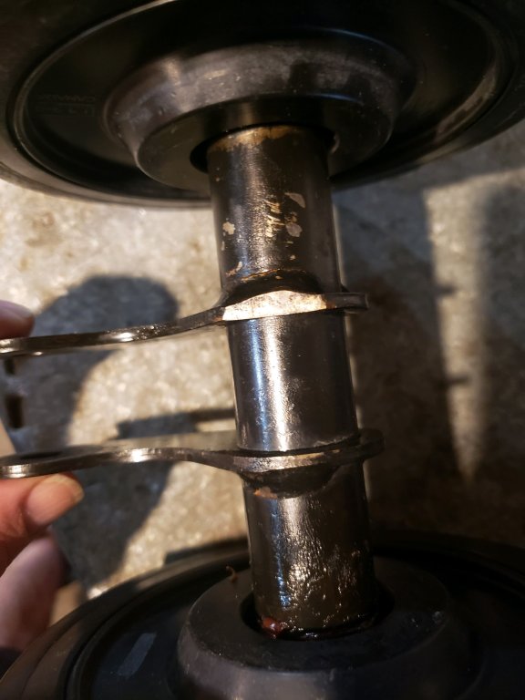

Is this where you guys are grinding down to prevent shock from hitting.
First picture wear on cross shaft.
Second picture shows the point on shock that is rubbing.
Looks like we need to grind down the cross shaft some so it wont hit the shock.

Also looks like I need to turn this wheel around so the lever on the qs3 shock does not rub on it anymore.
Yup thats the spot Inc.

That wheel in second picture looks to have a good size hole in the face. The water gets in that hole and freezes and makes it bigger. Then it shreds
Guys look at your shocks. If that spot is there grind the arm like 1INC did. Damage has probably already been done. These things are leaking!

I ground this area down hoping shock won't hit anymore.

I personally think if you have the Witness mark on your shock the eyelet has been bent already and body tube cracked. Only reason it’s not leaking is they use a lot of Loctite on the body where it screws into the eyelet. The Loctite isn’t supposed to be sealing it. The oring is. Loctite gets old and then it leaks. Big job. Sucks
Final result of this is the body tube cracks right in line with the Resevoir/clicker eyelet. Here is 2. On Backorder from Fox!
