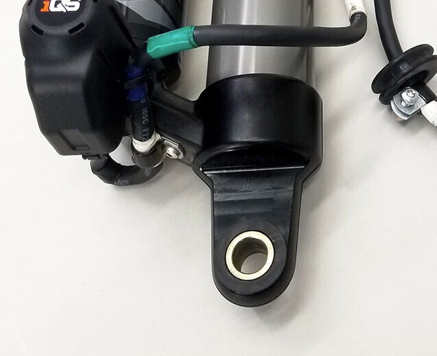

The IQS shocks have the reservoir bracket at an angle away from the eye where the shock attaches, not perpendicular to the shock body like the QS3.
QS3, reservoir bracket extends perpendicular from shock body
IQS, you can see how the angle of the reservoir creates clearance.
Also, the eyelet itself sticks out further

Here is the fix!
Look at the new angle on the shock end!
Cat knows they have an issue here and superceded the original part number and this is the new one!
3704-252 is the new part number for the 137" models 2014-2023 years.

I have parts ordered to do conversions. So far its showing available but its both the eyelet and the body. Not sure whats different on the body. Will find out when I get them. Kind of a sad situation really. Few old ones fail but parts hitting shock is just not right! At least now we can Identify which are the Culprits and which are Good.

I have more bad news about this. Even the older QS3R's are now cracking. So it is not a thread issue. If the witness mark is there on either shock with the straight eyelet you are on borrowed time. I would say for this season be darn sure your bumpstops are fresh and grind where it hits. Reports say that even grinding will not always prevent it. They really messed this one up. Sad situation.

Does changing to the 45 degree (is this the new design?) solve the problem?I have more bad news about this. Even the older QS3R's are now cracking. So it is not a thread issue. If the witness mark is there on either shock with the straight eyelet you are on borrowed time. I would say for this season be darn sure your bumpstops are fresh and grind where it hits. Reports say that even grinding will not always prevent it. They really messed this one up. Sad situation.View attachment 171248View attachment 171249
