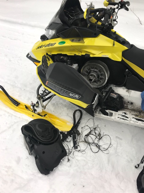

SIDE NOTE 1: 850 grenaded belt at 2000 miles. Took us an hour to get it out of clutches.

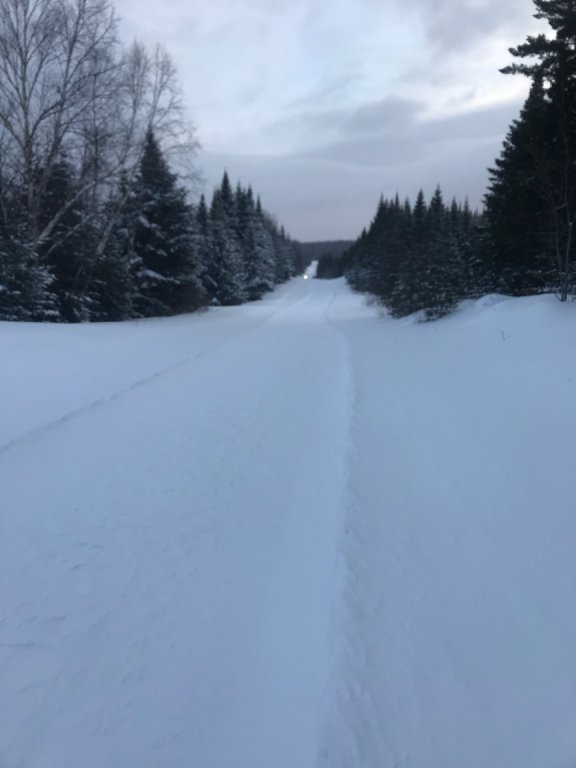

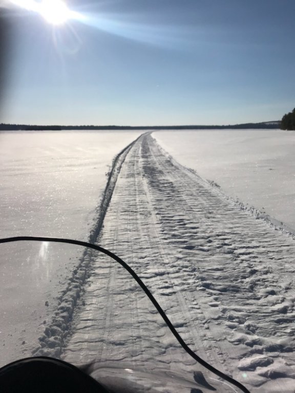

Some of the trails i had to "deal" with
