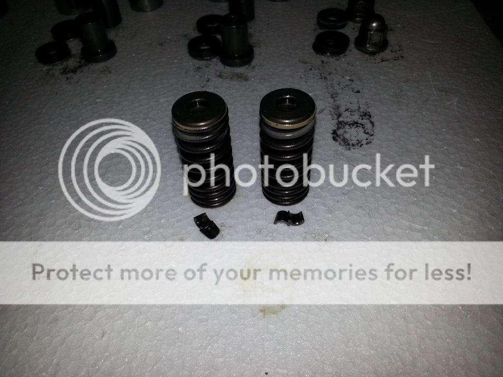

The exhaust valves removed.
One broken and one bent.
The valve springs and Locks removed.

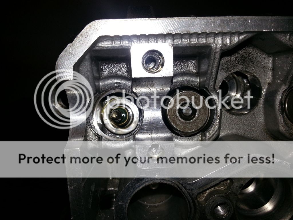

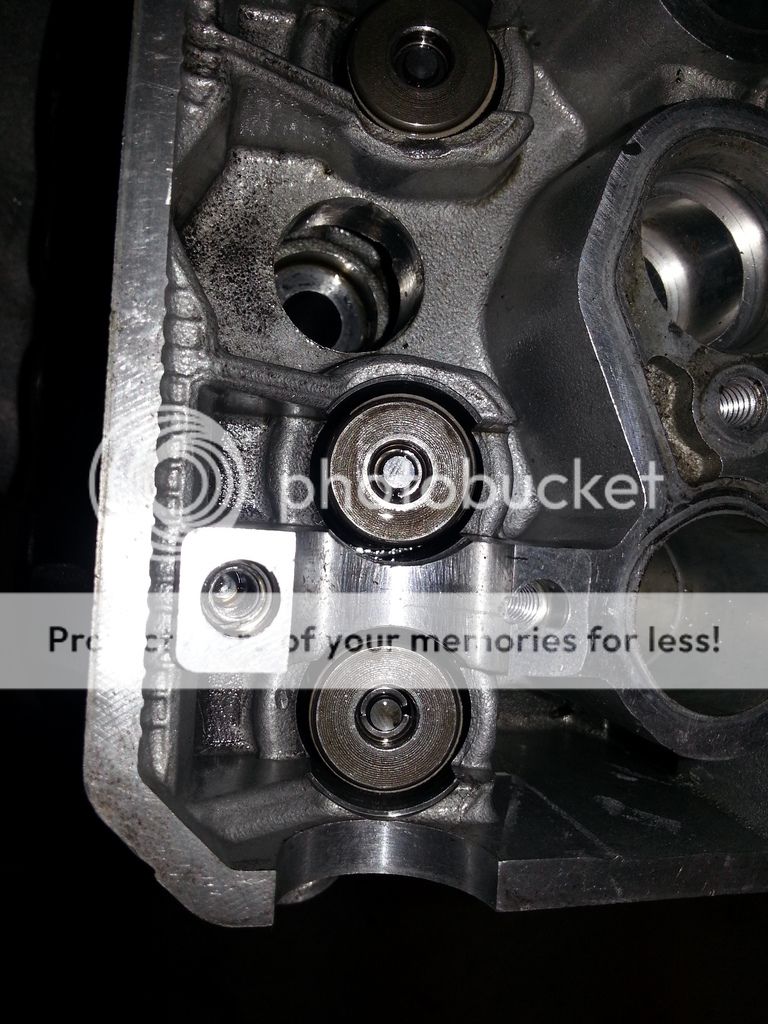

Before installing the exhaust valves i cleaned the cylinder head surface and valve seats.
New valves from my RX-1 cylinder head are going in.
They are the same part#s as on the Apex.
The Three valves on the intake are a bit different.
Two of them are longer, the outside ones.
The one in the middle are Shorter than the others.
I measured all valves for length to make sure I would not run into trouble.
The Intake valves measured: 9.18 cm, 9.02 cm, 9.18 cm
The exhaust valves measured: 8.92 cm, 8.92 cm
By measuring them I have made sure they go in the correct way.
I checked With a engine Builder if I had to change the valve guides because they had bits broken off.
He said that in order to change the valve guides you need a machine shop With presision Tools to be able to install New valve guildes correctly.
And even then it was not an easy job. He told me I was better off leaving them as they were, and to make sure the valves did go in and out without resistance.
He told me to make sure the surfaces that were broken off were free of metal shavings then to oil the guides and valves well With motor oil before installing them.
Before I installed the exhaust valves I used on of the old valves to push out possible metal shavings.
Then I used a 1200 grit sand paper to shave off possible metal shavings where the guide broke off.
I Applied motor oil on the guides and valves and installed them.
Put in the exhaust valves to make sure they would go in and out without resistance.
They did

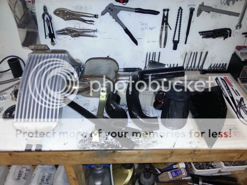

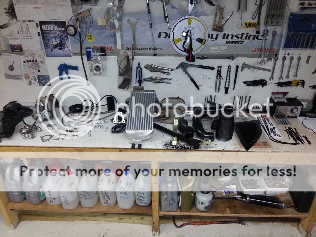

Got in a MCX270 turbokit for a customers Arctic Cat M7000.
Unpacking the turbo kit.
All parts on the work bench.

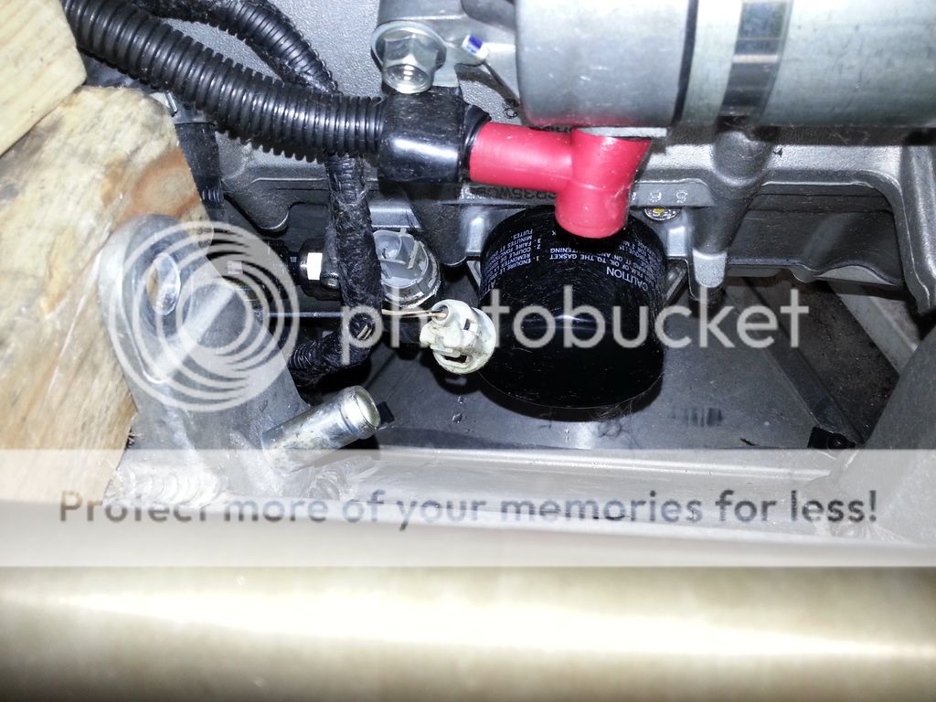

Oil line to turbo is Attached before the oil pressor sensor.
The cylinder head is done, valve shim clearance adjusted and New headgasket/shim installed.
With the oil line to the turbo and the coolant lines in Place I reinstalled the rear engine bolts and tightened Down the motor.

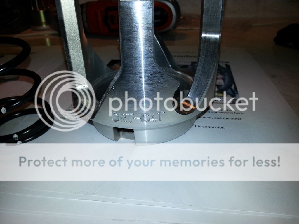

New clutch parts are going in to take care of the added Power
A New Helix is going in.
A New primary spring is going in.
New clutch weights are going in.

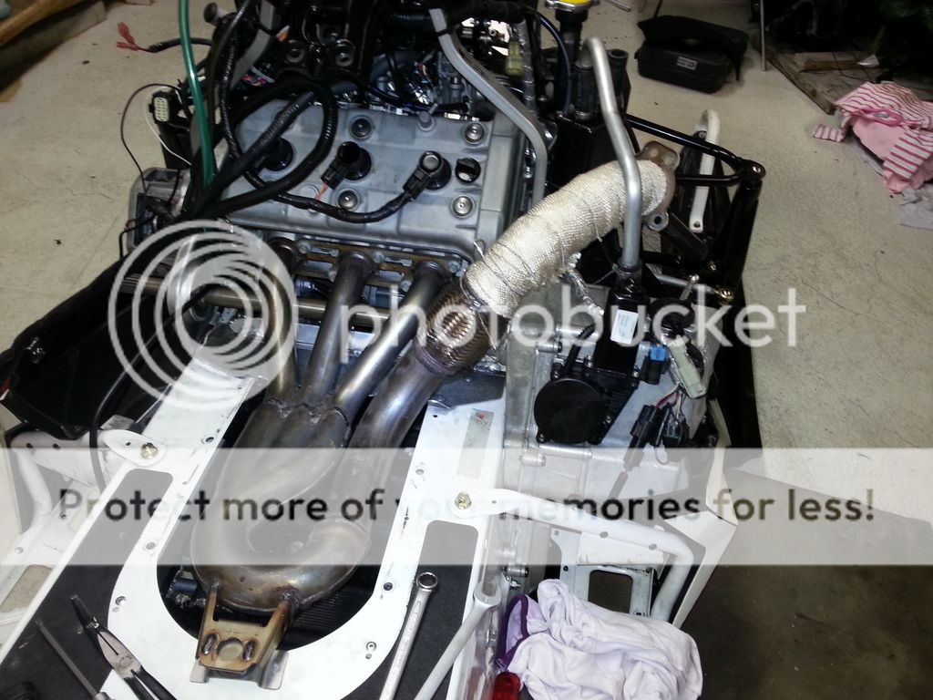

I have installed exhaust wrapping to reduce problems With radiant heat from the exhaust parts and turbo.
The turbo and exhaust parts are installed.
The sled is done.

Update - April 16. - Engine Rebuild, Apex 2006, valve shim adjustment.
Valves are installed.
Valve shims are and buckets are installed as well.
It's time to start the work adjusting the valve shim clearances.
First I will have to install the cams, then use the Yamaha feeler gauges to measure the clearances.
I assume it will be way off, at least at the #4 cylinder where I have changed all the valves.
I use a Excel spread sheet when calculating what shims to use after measuring is done.
I put in the current valve shim thickness (the number is stamped on the valve shims) into the spread sheet.
Then I put in the measured values.
I use the Yamaha valve shim feeler gauge.
The spread sheet calculates the proper valve shim thickness to install to get the desired valve clearance.
Install new shims and redo the prosess.
Iterate until all clearances are within specification.
Remember to tork the cam shaft cups to spec before measuring the valve clearance.
Spec is 10 Nm on the bolts.
You do not have to install the two cups closest to the cam gears.

The engine oil and filter was replaced, the chaincase got new oil as well.
