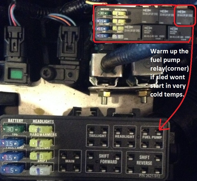

Fuel Pump relay needs to be warmed up in hand.
Must remove hood as they are located in the nose of sled.
Been talked about over and over, but lets do this again for anyone who has not seen.
Also may need to warm up the MAIN relay too, or others if need be.

Yep been a Yamaha problem for years. I guess they don't test these things in cold weather. The only question I have is if they were fueling up everything under the hood should still be warm. The kill switch freezing might make more sense since it's exposed to the cold wind and wouldn't take long to freeze.

I figured it might be a relay but I thought it was weird that the guy played with his kill switch and the lights came on and he was finally able to start his sled.
The funny thing is it happened to a Sidewinder and Thundercat within minutes at the pump.

Sounds like this would be a good thing to do before removing relays and removing panels. I did have my key switch freeze on me last year in the Gaspe. We rode in some drizzle before shutting them down for the night. Next morning everything had a layer of ice because it got cold and snowed on top of everything. First the key would not go in and when it did it took some time to get it to turn. The location of the key made it very hard to get any heat to it. This is only one of the reasons I like the DESS on my SkiDoo's.next time try it before removing your hood you see a have 2 friends that did that and it work every time but it always took a couple of warm blow before the cluster lights up!!!
