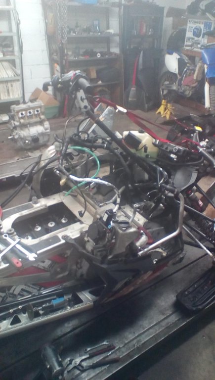

My wife’s 2014 Viper LTX had a similar issue and the correction required pulling the engine which in turn requires disassembly of about 75-80 % of the sled. Her sled was under warranty and the repair was done prior to the last ECU reflash/ update. The picture shows her sled during the repair process.
