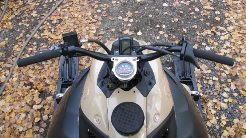

I decided today to really clean up the electrical. The stuff I'm deleting(TORS, killswitch, tail light, brake light) I'm going to take out way back in the harness by the clutch. The handwarmer will also be moved over there and the connectors for the handwarmer/thumbwarmer switch and headlight are getting re-routed right to the toggle switches. Here's a pic, I'll take another one tomorrow with the main harness open.
Toggle switches. Left one is the hand/thumb warmer switch and the right one is the headlight.

I threw some oil in the sled and fired it up real quick to make sure everything worked. I wanted to do this before I wrapped everything and had the radiator back in(in case I had a bad splice somewhere). Toggle switches work good, I can cycle through the handwarmer settings like normal. Just have to wrap it all nice, put the radiator back in and put some stickers on
