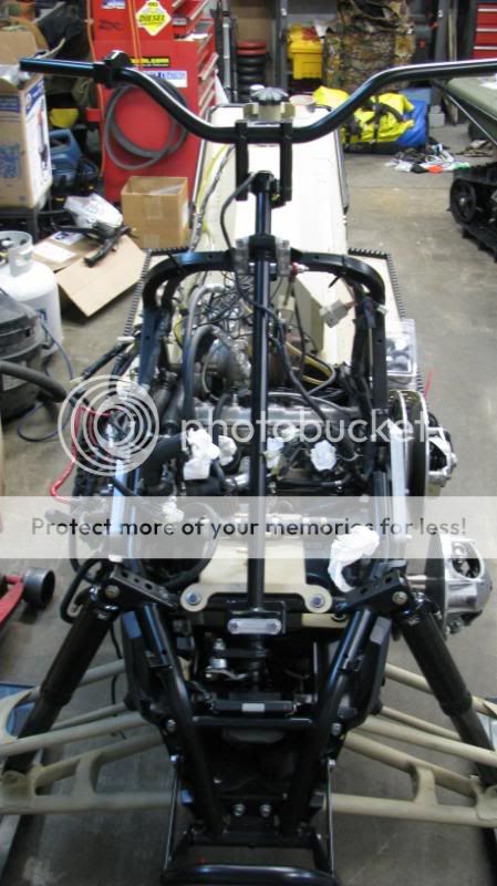

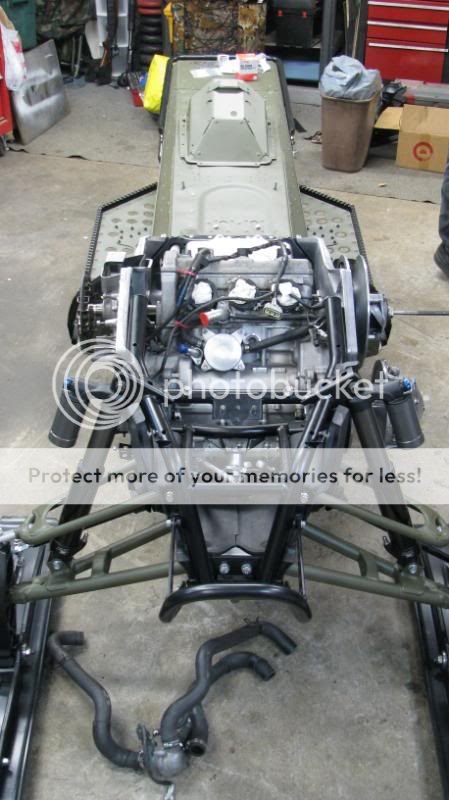

I got the hoses in, started the wiring and some radom stuff. Kinda at a stand still until i get my turbo stuff in, hopefully it will be soon.
Caleb got his clutches on and aligned, skis on and header in. Starting to look like a sled now.

Heres a sneek peek of caleb's sled.

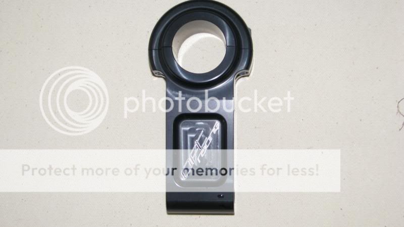

- wiring in the RSI warmers. Can't decide if I want to do the blue/red together or not. I want hot hands and I have aluminum bars, but I also don't want to be melting holes in my grips.
pic...should be extremely clean when done
