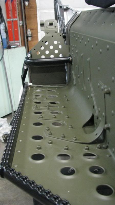

Calebs extrusions and footwells coming together
So clean!
This thing is gonna look mean
So clean!

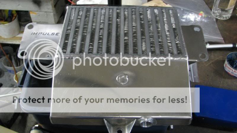

Put a quick shine on the intercooler
Lots of tunnel clearance
