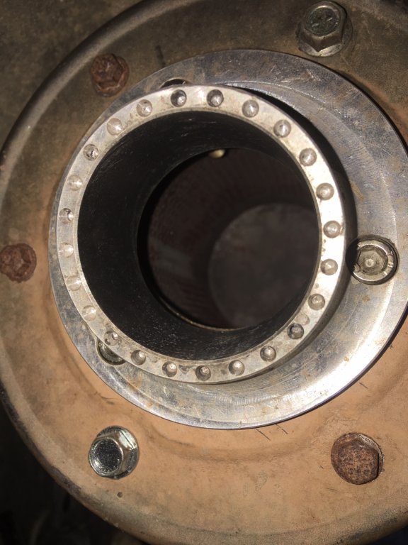

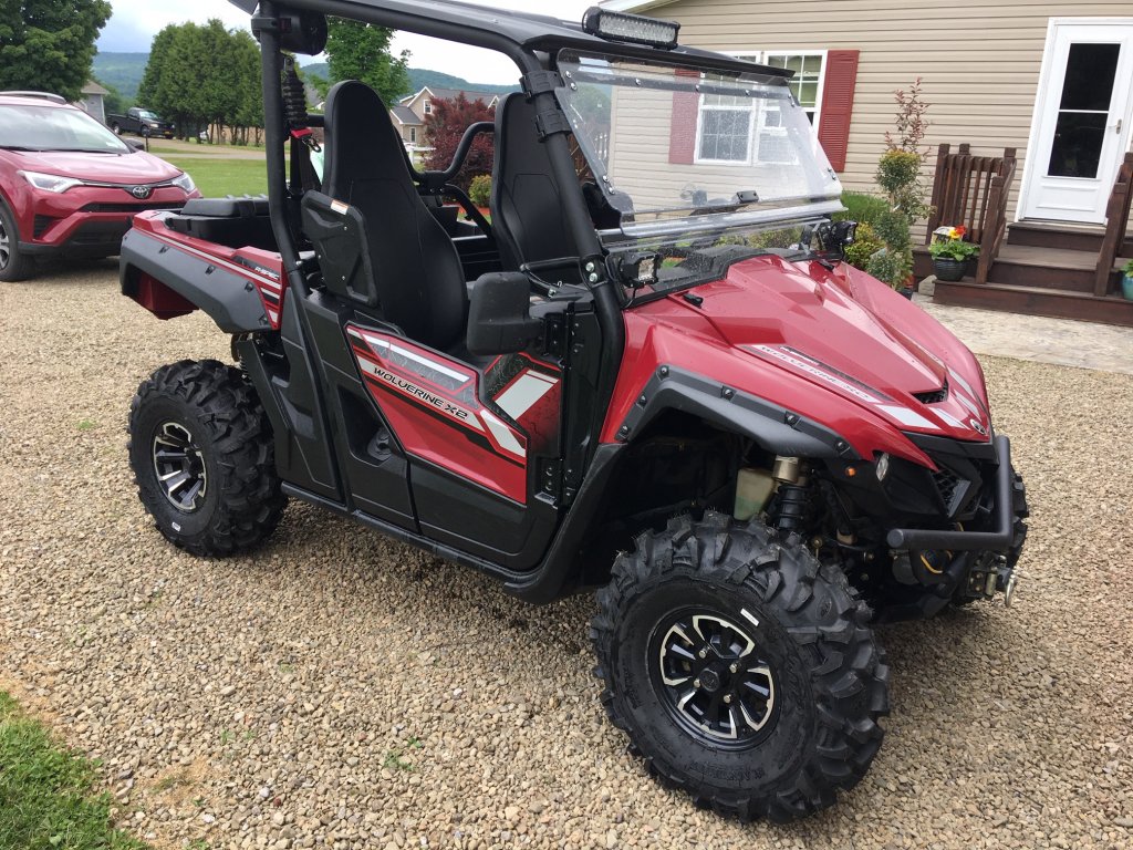

Had to replace the junk stock tires on the X2. With the rocky terrain around here the 6 ply tires don't hold up so I went with the ITP Blackwater Evolution 8 ply with armored sidewalls. I Also went with the taller 28x10x12 tires on all four stock rims which helps add to the much needed ground clearance. My next set of tires will be 28" on 14" rims so they can be rotated.
My X2 also had a startup problem when the engine was cold. It would take 2-3 attempts before the engine would stay running. Others have reported the same issue and I've been hearing that the Weller or Alba Racing ECU flash will correct it (which I still have not done). By chance I found another fix to correct the start problem. I had an old Yamaha Grizzly 660 billet exhaust tip laying around and decided to see if it could be used on the X2. I cut out the small outlet on the X2's muffler and with a little modification installed the Grizzly output tip. It made the muffler slightly louder with a deeper tone but more importantly the startup issue was gone which suggest that the these mufflers are way to restrictive.

Nice work!! Great little review!
