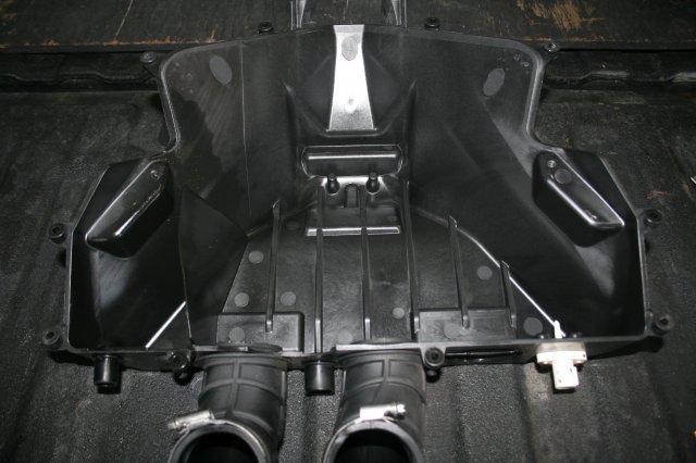

I am warning people that if the SUPPORT is not in original position then the DIVIDER may crack. Support needs to be in the two protrusions on the divider to operate as intended. Or ditch the divider. That is what Excell told me to do. I am ditching the divider and if I am not happy with results I will install a new divider and bend back the support to fit the protrusions I have already cut a flat on that airhorn so it will fit without interfering with the support. I do not know why the divider cracked but based on the amount of wear I believe it to be from fluttering like a reed in a duck call. Bending the support enough that it wont fit in the protrusions on divider is defeating the purpose of the support and will cause this issue in my opinion. Here is some pics showing the components.
The box doesn't go together worth a #*$&@ if u don't get it back in the right spot back in those nubs..this explains a lot..I understand the post more clearly now.
Yes. Support was designed to be in those nubs. If not either because of bending or because that airhorn pushes it over I believe this will happen. No proof though other than what you see here. Seems I am the only one. For that I have no explanation. I put pics up explaining the components better.

Divider locates into slot in the shadow:

Here. Number 5

The 2015 do have that plastic divider TD Max.
stingray719
That divider does a couple things, noise and to keep turbulence at high RPM down. Did we find TDmax another 5mph?
stingray719
WAIT, who else has an LE that can look and see if there's has one?
I doubt it. I couldnt feel any difference but I sure look at it and think it belongs in there. They dont put a piece like that in there for no reason. I just cant chance it so it gone.

It's got one,my airbox has that divider but when I did my mod the company that originally did it and Dyno'd it said to remove the divider so you won't miss it
