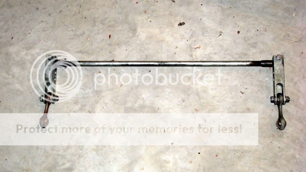

Yea I think I will just stick with the stock ZX-2 rear wheels. The Apex is a pretty easy sled to get up on one side to carve. It should be even easier now as well because I pulled the sway bar out the other day. One of the bushings holding the sway bar was completely worn, I will have to get a picture of it. This afternoon I will try and get the rail extensions on, may need another body to help me though. We will see.

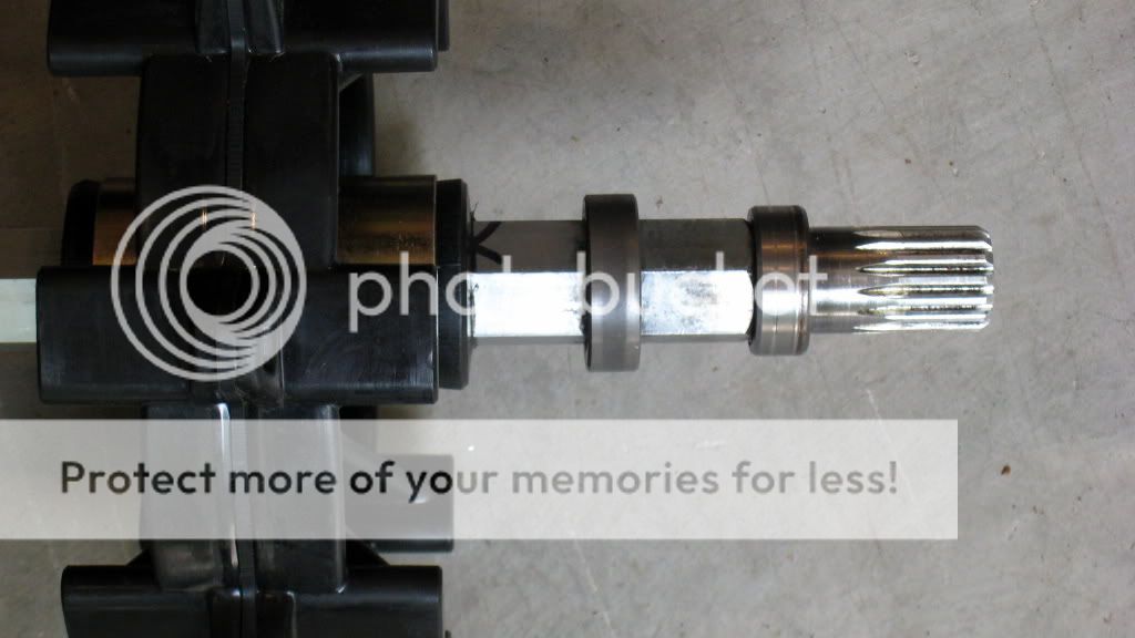

The extroverts are on the driveshaft however one is not on perfectly straight so I brought it back to the dealer and they are fixing it. Here is a picture of the both the straight one and the one which is on a bit crooked.
Anybody know what do with two collars on either side of the shaft that are held on by set screws, havent looked at them much, but do i have to put them where they were originally or can I pound them right up to drivers on the shaft and tighten the set screws there.
I pulled the swaybar out the other day, will probably put it back in later in the snow season when I get out on the trails.

A little update, the dealer is having problems getting the extrovert drivers to line up. I called Wahl Bros racing, and they said obviously that should not be happening. So tommorow the dealer is going to take the driver that isnt lining up and put in on the other way and see if that doesn't help. If it still doesnt line up, it could just be a bad driver so I will send the driveshaft and drivers into Wahl racing and he will take care of it and fix it for me.
