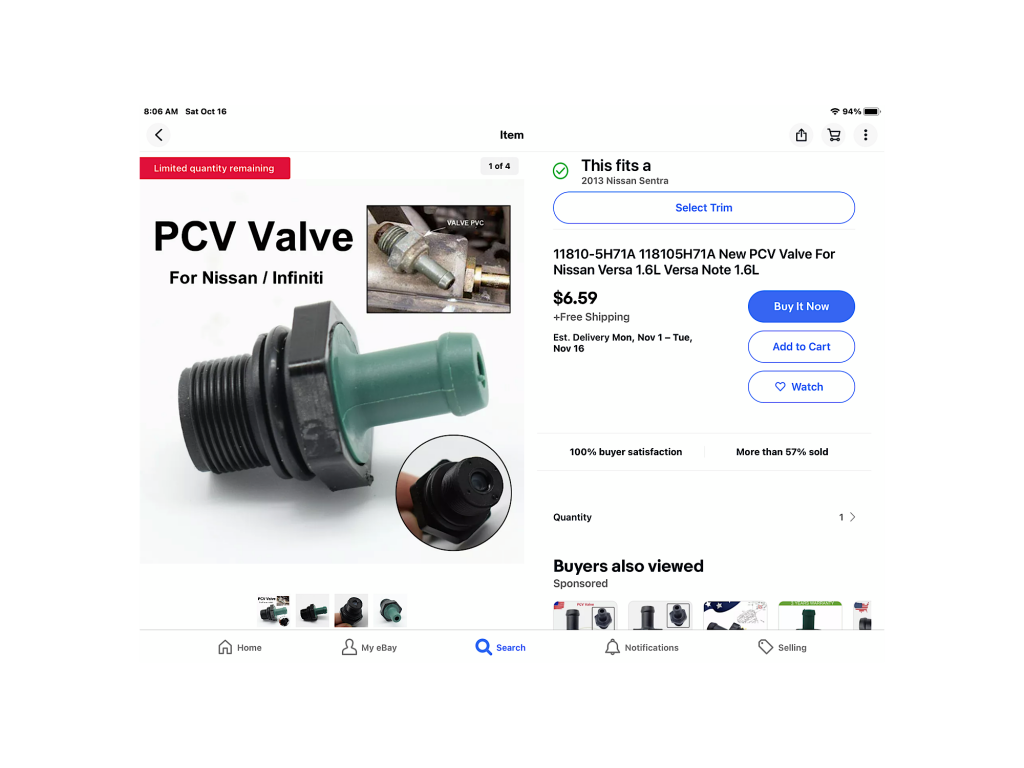

Wouldn’t something as simple as this just work? A PCV Valve that has the same thread and diameter as the oil cap on the oil tank. Screw it on in place of the cap. Add some plastic tubing and loop it up and then down towards the belly pan. If the ROV freezes the oil tank builds pressure and the valve in the PCV body opens allowing pressure to escape. Once the ROV thaws the valve closes when the pressure subsides.

Your logic makes sense, but then there is a second valve that could freeze over so really we are still at risk of pressure build up from a frozen valve.Wouldn’t something as simple as this just work? A PCV Valve that has the same thread and diameter as the oil cap on the oil tank. Screw it on in place of the cap. Add some plastic tubing and loop it up and then down towards the belly pan. If the ROV freezes the oil tank builds pressure and the valve in the PCV body opens allowing pressure to escape. Once the ROV thaws the valve closes when the pressure subsides.
