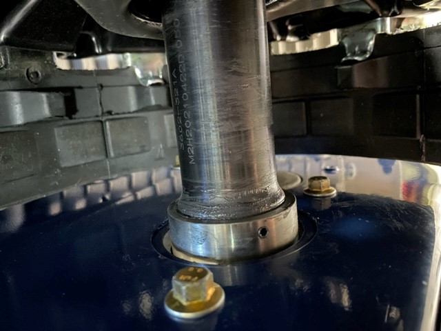

My bearing is pressed on. Shaft was spray welded, then ground on center to produce a .0003-.0005" press fit to bearing. I use BOP puller to remove it (with caliper housing) and a simple press tool to re-install. Press tool is just a 3/8" threaded rod with nuts and washers on both ends. It's made so it comes apart into 3 pieces to be able to insert inside track shaft without interfering with belly pan on either side (have to remove rubber plug with magnets in it on chain case side). I just remove caliper housing with bearing, service it, then just use press tool to re-install.Knapp,

Step on chain case side locates shaft against bearing on that side. I put both bottom gears on to make sure outer circlip goes on. Then press caliper housing on until it just contacts tunnel (not deform it or cause it go be pushed in). I put the 3 bolts in and start to tighten them. I just watch as 3 bolts tighten to make sure tunnel doesn't move. If need be, I can turn my outside nut to press in a bit more. It's very controllable. There is also no side load on bearing.How do u know when u have it pressed into the correct position on drive shaft ?
I like this method.
I've run my sled 3+ years now like this (6,500+ miles). No issues at all. Shaft can't spin in bearing. Bearing is replaceable (no need for machining a slot, etc). Everything looks like new when I serviced it this spring. Pic shows shaft after spray weld and grinding on center to produce a press fit to bearing.
