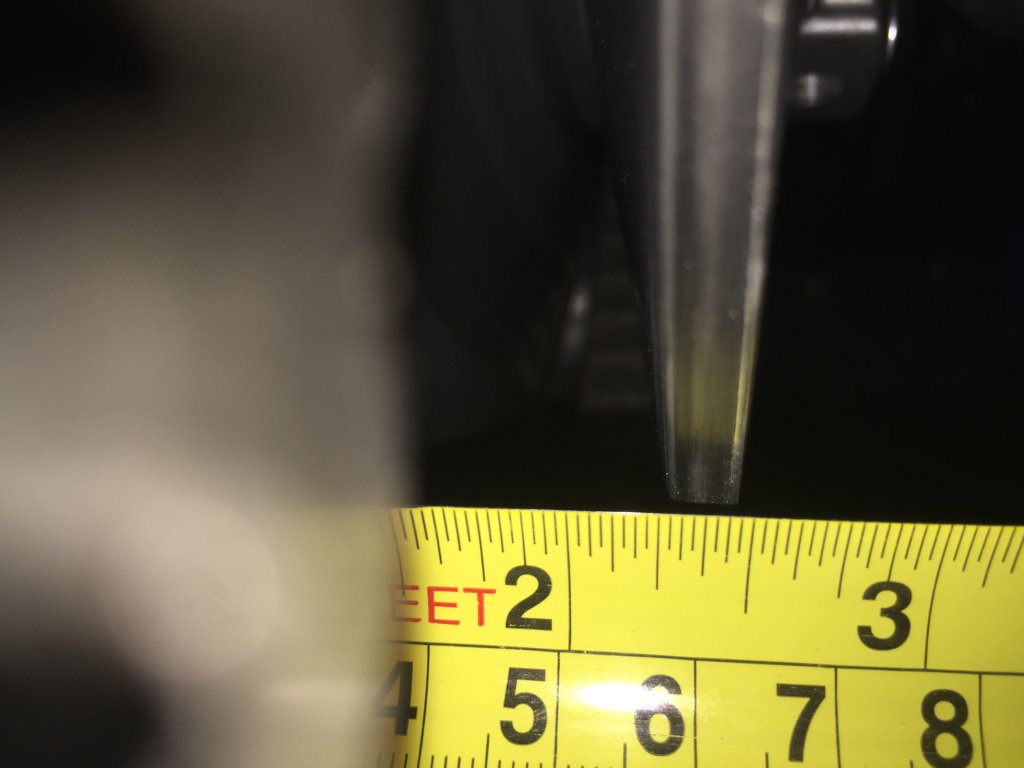

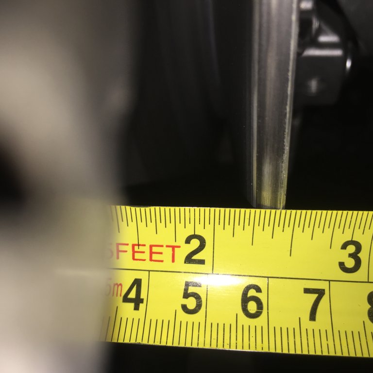

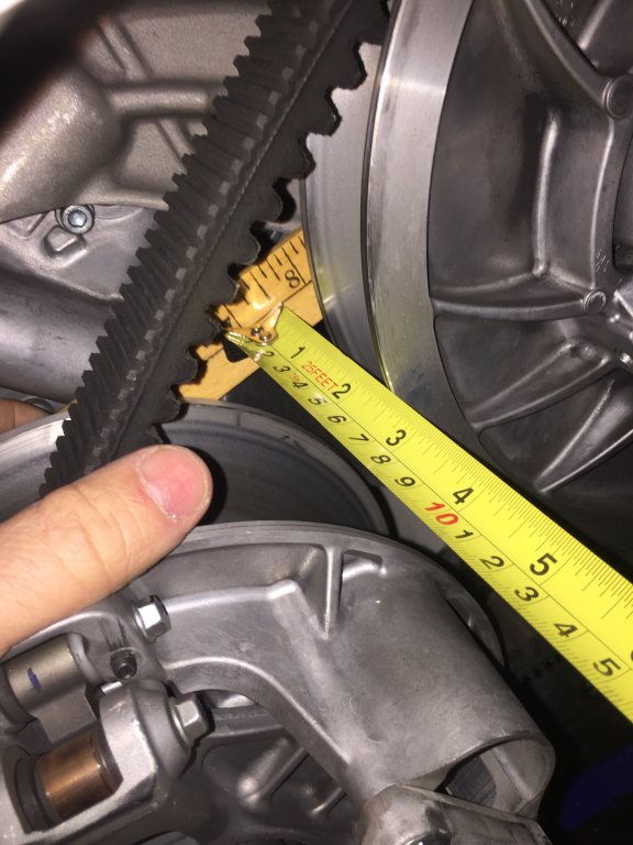

Everyone I have checked and made the clutch offset around 61mm has been good since.

As long as your holding the tape straight it looks good. your real close to 61mm in the pic.View attachment 126191 View attachment 126190 View attachment 126189 ok am I doing this right? I also have a shim behind the secondary shaft. What you think?

Thanks. Thats why i did it a couple times. Kinda tricky holding everything in place and taking a picture. I havent ran it with the shim behind secondary yet. Might tighten up the osp adjuster a bit to bring the 8dn up a bit.As long as your holding the tape straight it looks good. your real close to 61mm in the pic.

Shim fixed mine.Thanks. Thats why i did it a couple times. Kinda tricky holding everything in place and taking a picture. I havent ran it with the shim behind secondary yet. Might tighten up the osp adjuster a bit to bring the 8dn up a bit.
