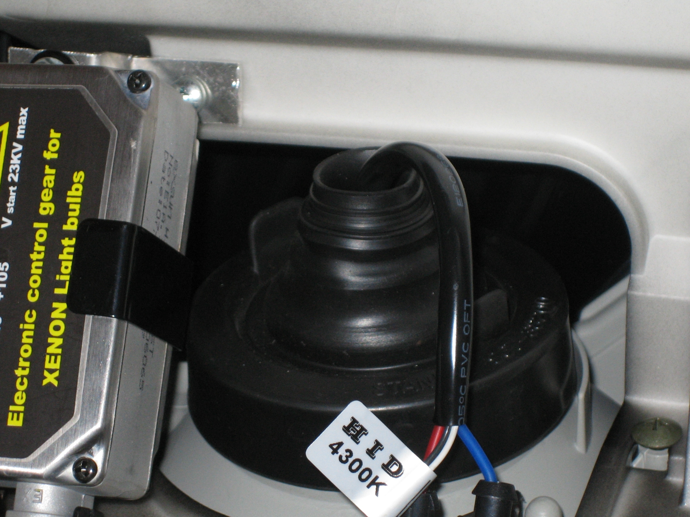

HID Bi-xenon kit installed in 2008 FX NytroRTX
No, why do you think that? They only uses 35w.
They are accually cooler then original light. It takes longer for the snow to melt from the glass.
My mechanic suggested to me that it might melt the housing..Said he's seen it with others putting in bigger bulbs..I don't have any experience with these HID's so I was curious before I had them installed..On the instructions it says they will shut off if reaching a certain temperature..I think its the ballast that gets hot..
