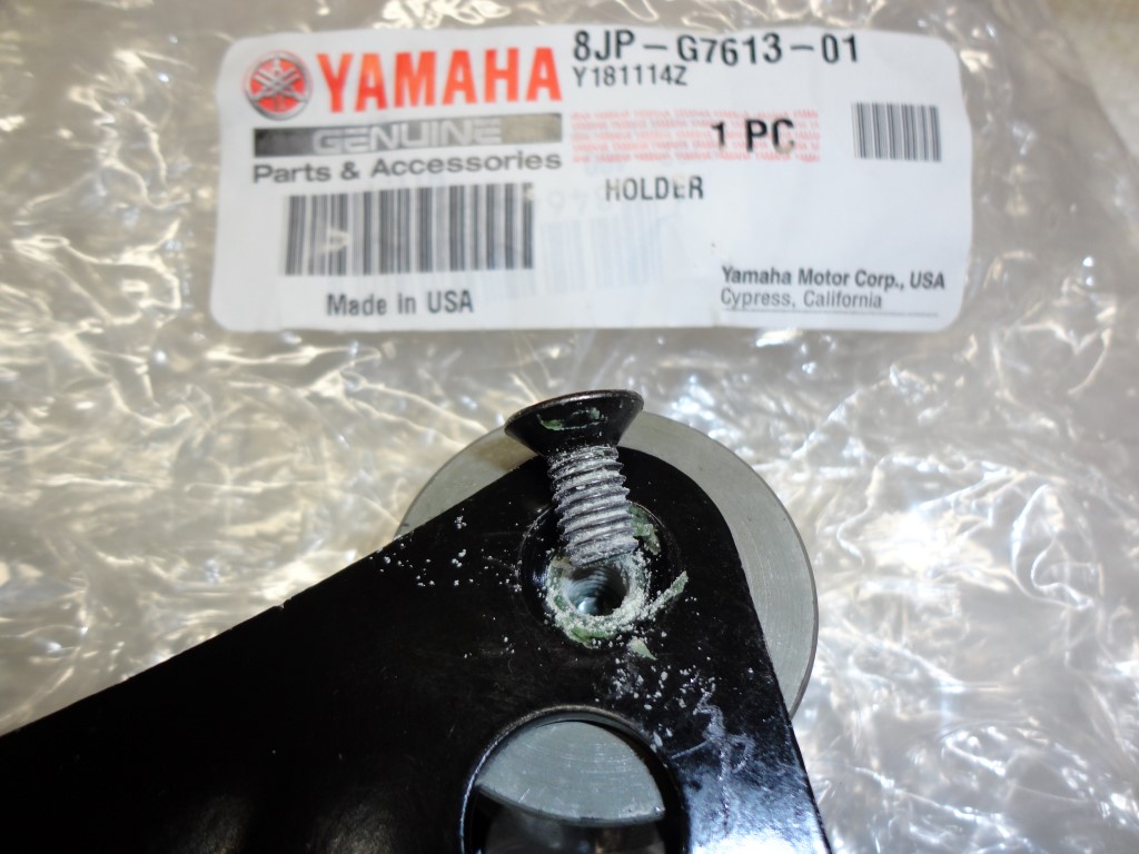

Update. I got the new one. Very tight and lots of Loctite. No way its going to come loose.
I can confirm this also with new Tensioner. They knew. God Dang becoming X-Files around here and the darn Little Green Men at Cat have taken to Sabotage!2019 Srx's have green loctite on the roller bolts just confirmed on my sled at the dealer

Update. I got the new one. Very tight and lots of Loctite. No way its going to come loose.View attachment 143301
Do you know when the updated part came out? I have an '18 and trying to decide if I should take the chaincase back apart to check this (already changed the oil) before this season or just wait until next winter and do it then. Already changed the engine oil too... so, really not looking for a "make work" project but will do it if it's been an issue on the 18's. Thanks
I do not but the 01 is definitely new. Not sure of any way of knowing actual date of change. Will ask parts guy at dealer if I get a chance.Do you know when the updated part came out? I have an '18 and trying to decide if I should take the chaincase back apart to check this (already changed the oil) before this season or just wait until next winter and do it then. Already changed the engine oil too... so, really not looking for a "make work" project but will do it if it's been an issue on the 18's. Thanks

My 2017 Winder has green loc-tite on it. I redid it with red.

Took mine apart yesterday... Bots are tight with 3000 miles... Left them alone and reassembled..... Fingers crossed...

So what is the verdict on this? Is it random sleds that have no loc tite on the screws? Seems random as some are good and some loose?

Just wondering why the red instead of green? Not saying you did anything wrong just wondering?My 2017 Winder has green loc-tite on it. I redid it with red.
yamaha06
Mine also had green loctite on them, but were prettt easy to remove. I cleaned them up and re-installed with red.
