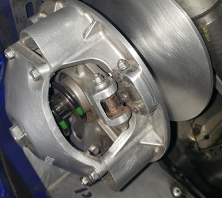

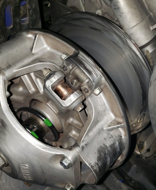

View attachment 159297 View attachment 159298
Got this sidewinder all set up!! This guy has been blowing belts original offset 61mm
Removed primary and checked that stub shaft bearing was properly seated . Bearing needed to be reseated and new offset measurement came in at 60mm. Had 2.3mm machined and now he is what I feel is "on the $$"
Offset is now 57.7mm!!
New thunder products 14.8 rollers should be here tomorrow and sled will go back to customer to ride the weekend!!
I will update on Monday if he blows belts or not...
I am pretty confident he will have no issues since I been pretty successful on helping guys with belt issues in the last 2 seasons following these steps!

Many times if the bearing was pushed in you will have rub marks on the back of the primary from the stub shaft housing bolts.
I just use feeler gauge and feel for a gap between the housing an bearing
Rub marks from stubs shaft housing bolts.
Check with feeler gauges to confirm if there is a gap between bearing and housing right on machine (you do not need to remove the assembly from motor)
This pic is obvious it moved with the noticeable gap between bearing and housing
