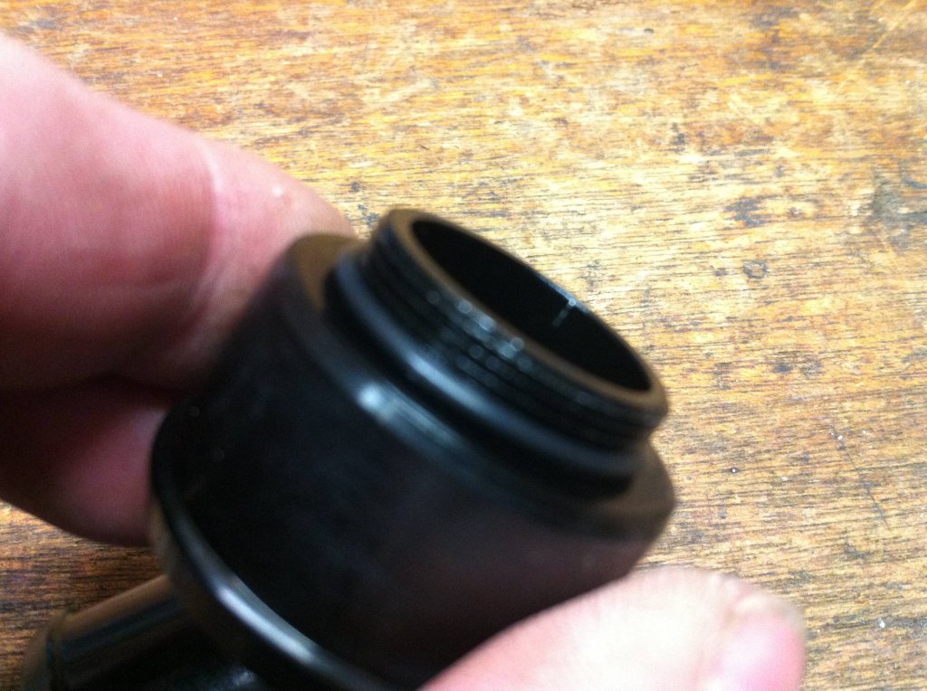

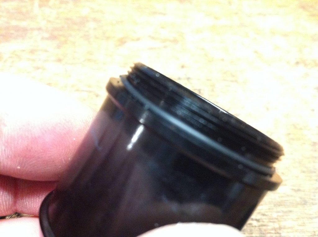

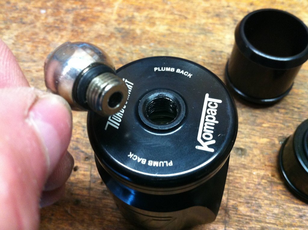

Not sure if you meant stock BOV?Dan, did you tighten down the went tube spout on top of the BOV? Mine was loose. Also the port that exits the side was loose too. Weird. Now I’m really looking forward to getting that leak checker!
I did tighten down the TS BOV for sure, all 3 attachment points on the TS BOV are threaded and use a O-ring to seal when tightened. I lined up the top small vent nipple to the angle I wanted, and then tightened it down there(1/2" 6 point socket). The other two connections also got a good hand tightening, to bottom out the O-rings.
A couple pics for those installing one of these TS BOVs.
Dan
Dan
View attachment 133134 View attachment 133135 View attachment 133136 View attachment 133137
Thanks Dan, that’s exactly what I was hoping to see! I tightened down the nipple on top, but am going to take it all apart and check the other 2.

Is there any merit to using white plumbers tape on the thread for better seal of these threaded parts?
MS
MS
KnappAttack
- Feb 19, 2004
- 4,884
- 6,190
- Welch MN
- 2023 Sidewinder LTX-LE
2017 Sidewinder LTX-LE
MS
No, they are o-ringed. You'd only use teflon tape on tapered pipe threads.
