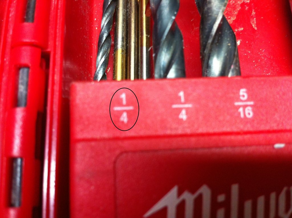

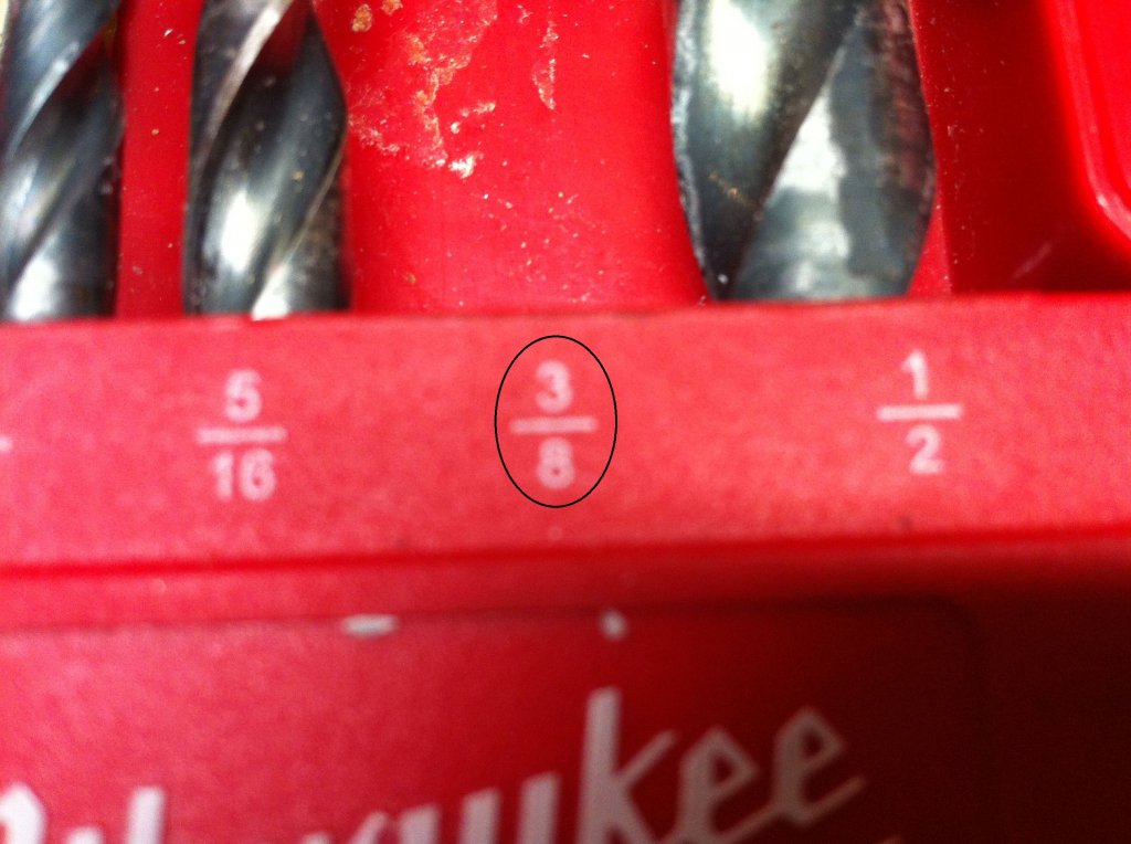

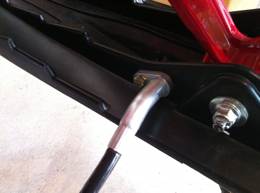

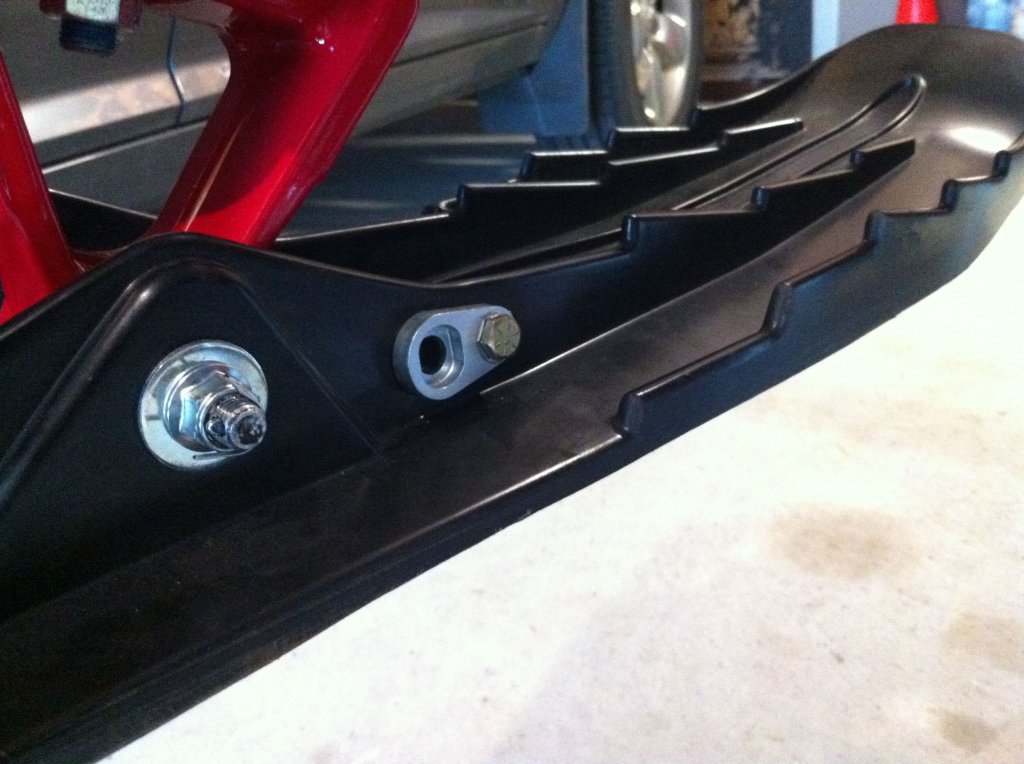

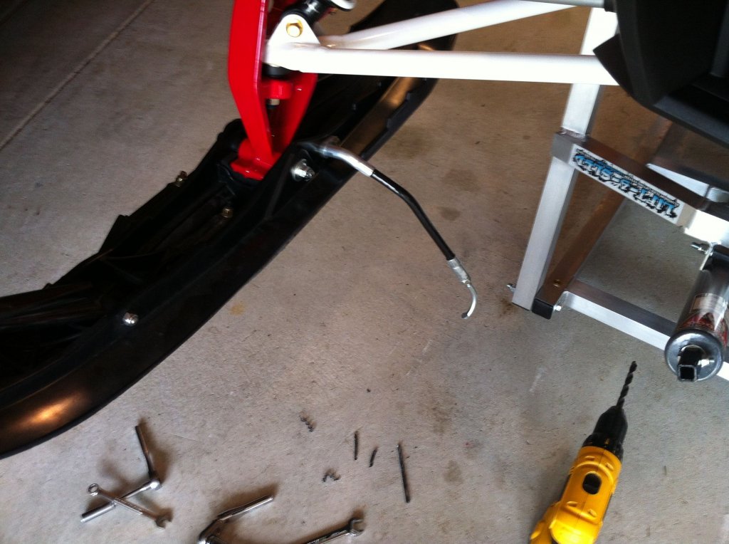

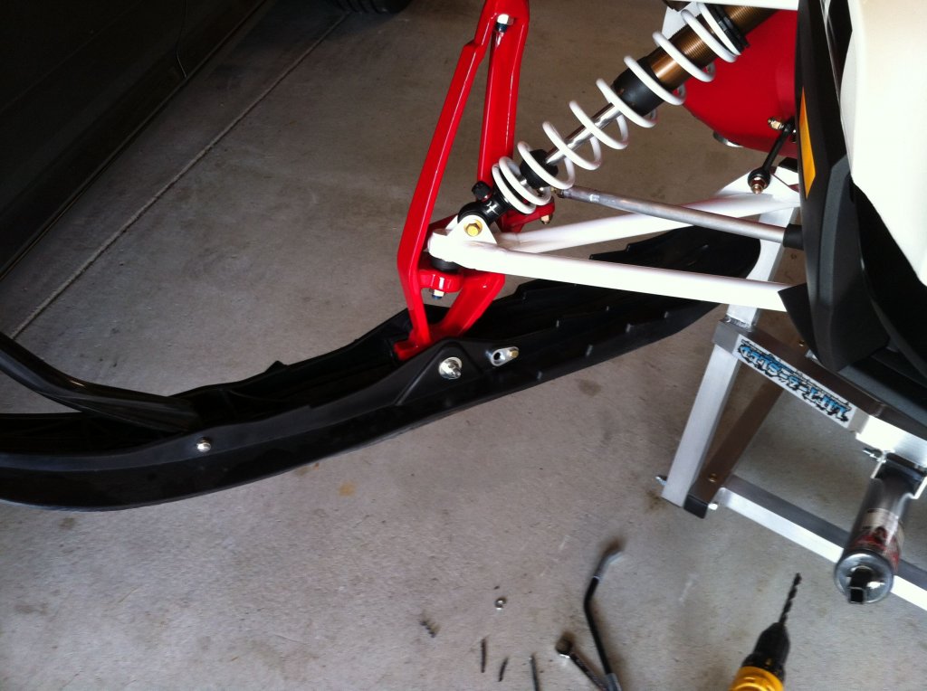

Came across this design in another thread here on TY a few weeks ago. PowderFalcon posted some pics of his setup, and the "anti-swivel" design caught my eye instantly. I knew I only wanted the ski mounted type, but I was veering away from the cable style as I had seen them spin often. So with this anti-spin design, I really felt these were nice, and look good too. I don't need them often, so I wanted something that looked good removed and easily attached for those certain days when I may need the extra cooling.
The Trail Blizzer really is a top quality kit, and they look great with the cable being covered and not exposed.
I will leave the plates on the ski's, and then just keep scratchers in my tunnel bag along with a 14mm socket and can slap them on in no time on the trail. Also I will add a large flat washer to the backside of the 14mm bolt, to help support it against the plastic ski leg.
I decided to drill the holes and mount them behind the spindles, as I know the pilot skis need all the strength they can get in those front legs. 1/4" hole for the smaller bolt, and 3/8'' hole for main bolt.
They can be hooked up onto back of ski's, but I only plan to run these when needed, and remove them for all normal riding. Not a fan of the hook/holders ect...not the greatest looking.

Hmmmm.....I believe there is only one trail blizzer. Let me check.Dan, can you give me the part number of your scratchers that you purchase, there are three listed.
I think the only different part numbers are for the diff tips...steel, carbide, pointy ect....
Mine are these....TB03-400 Has a rounded carbide, more for snow trails then glare ice. Ice you may want pointy.
