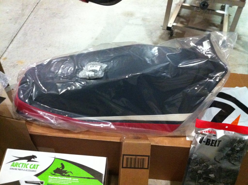

Thanks Dan...just picked up my seat today. Found out if you want the seat heater model you have to order the 2017 part number which is the one you listed. 2018 seats do not have the heater option.2017 BTX Seat
One of the first things I did was slap on the new seat. I knew ever since early LAST season I wanted the Mountain style seat. I rode a BTX at the demo, and also saw another cat with one and just loved the feel of it. And the bonus is, it allows for more tunnel space behind the seat for my LinQ setup(more on that later) as I wanted to keep the smaller stock tunnel bag in place.
I priced out buying mt. seat foam and doing the swap ect....sure its cheaper but after some talking with my dealer, and the price he gave me on a new seat...I felt it was smarted to just buy a new seat all ready to slap on, has heater and all. So The bonus is I can sell stocker, or keep it for when sled goes down the road later. And have a mt. seat for a future sled.
Just remove the screw at back of seat tail, and unclip the clip, unplug seat heater cable, slide seat rearward & seat pops right off....reinstall new one, dont forget to plug in seat heater cable.
Comparison pic of shorter MT. seat vs stocker at tail....
BTX(MT.)Seat installed

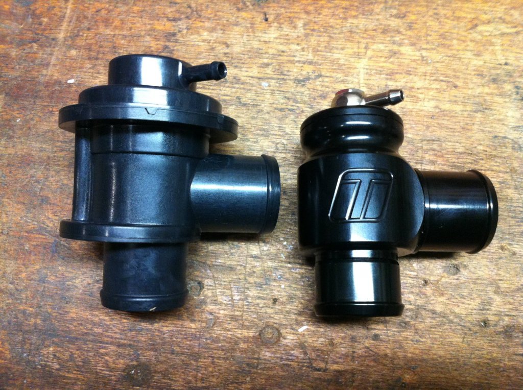

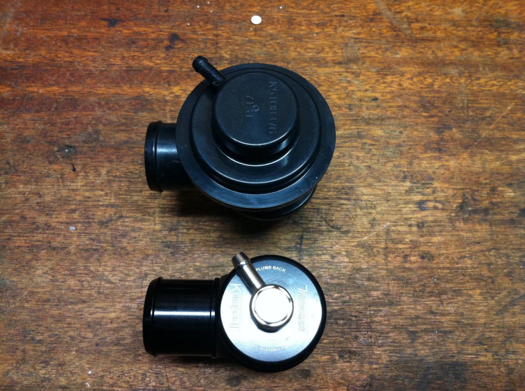

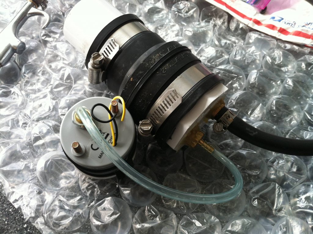

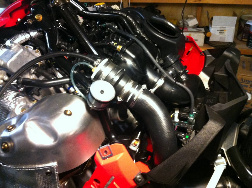

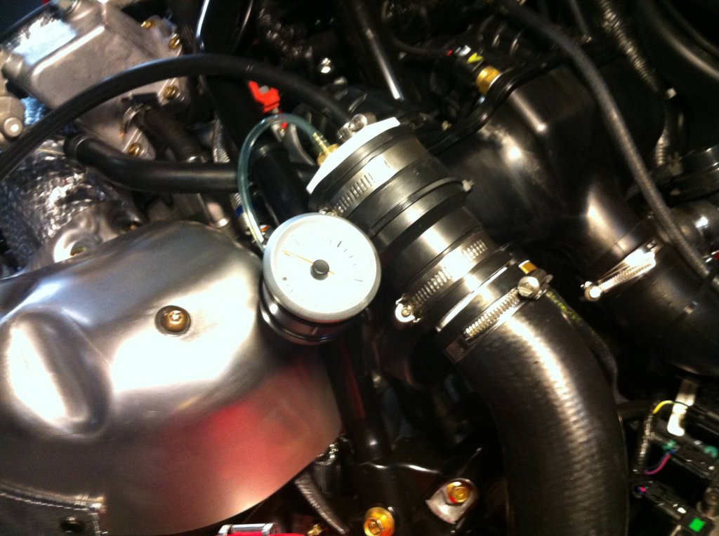

So Dan that turbosmart BOV is a direct bolt in,same hook up as stocker?Boost leak testing(All credit to Beerman)
After a few conversations last winter, I was fairly certain I would opt for an aftermarket BOV, as it had been said the stock BOV starts to seep around 17psi. So knowing I will be wicking up the boost shortly, I decided to grab a TurboSmart BOV.(part number below)
That being said, Ben and a few others have found leaks on some sleds over the past yr. Not all, and likely very few....but felt it would be nice for my OCD mind to know I have no leaks. So when beerman came up with the tester, I was all in. As you all know by now...Art has been kind enough to make up two testers and will be sending it around to anyone who wants to test their own. For US guys who want to use his tester Yankees Go Here , And for our Canuk brothers who want to use the leak tester, Canuks Go Here.
I have it now, and got my testing done today....I will say right off the bat, that mine had no leaks. What I found interesting is mine did not let go of any PSI(quickly) all the way up to 30psi. I had to hold the clutch at TDC as 30psi would want to turn the crank. lol
Now, I will also say my stock BOV held just fine, and the PSI does seep down slowly, which I believe is normal after watching Art's video. However mine does not seem to let go as his did in his video, which we think may be cause mine is brand new with ZERO MILES on ticker.
I installed the BOV I got from TurboSmart as I know I will be wicking up the boost soon, Just a few pics below and also a few of the tester. See this post for detailed info before installing the TurboSmart BOV
Huge shout out to Beerman, thanks Art!
Dan

Yes.....works nicely.So Dan that turbosmart BOV is a direct bolt in,same hook up as stocker?
Is it noisy? I'm guessing it's not needed on a stock sw?

ok thanks dan.Yes.....works nicely.

No, its quiet if installed same as stock. Likely not needed on stocker.Is it noisy? I'm guessing it's not needed on a stock sw?
