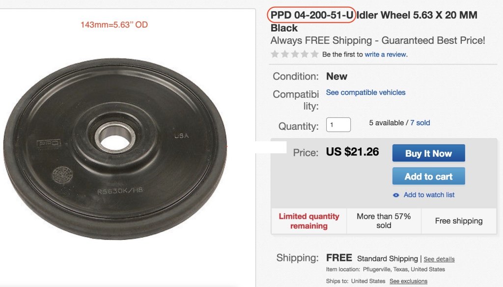

First issue I saw was the 2 inner idler wheels are losing rubber. Outers all look mint, and all bearing are perfectly quiet still. I know these Soucy brand wheels are not the best, and since I have studs up the middle I attribute the inners getting bad due to the studs. I will try to source PPD idlers for replacement.

I have the same issue with the inner idler wheels! My sled has 2500 miles on it but r
They are not as bad as seen in the photo here. Would also like to find replacements.
