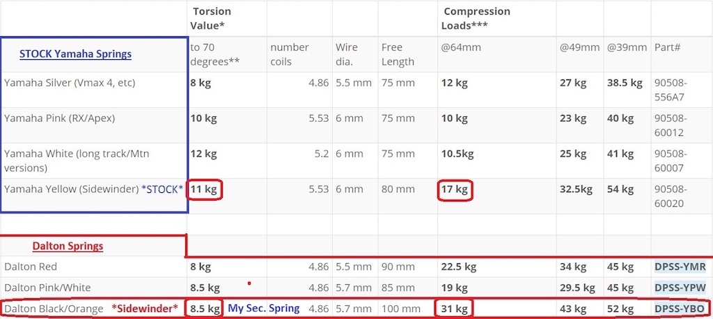

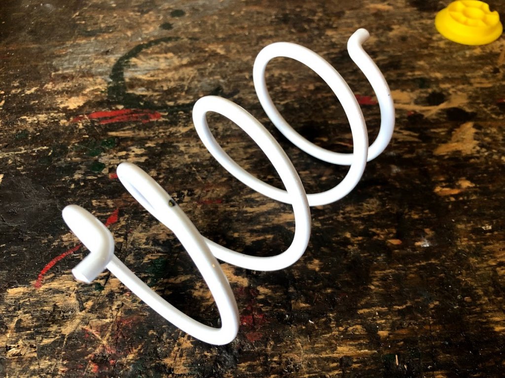

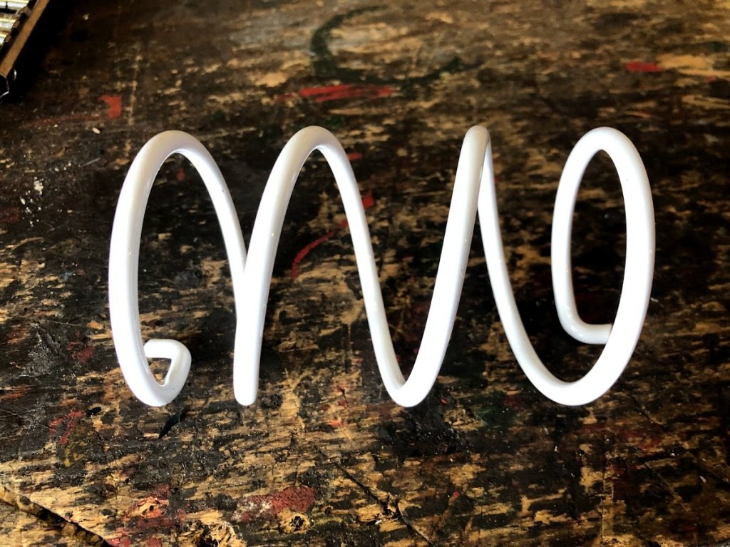

Dalton WHITE Secondary spring: DPSS-W(Made for Cats)
Im testing this spring now. Aiming for more engine braking, better backshift, and even better belt grip. Will be testing this to see how it compares to my last setup with B/O at 90.
I have started at 9/1 for tension backpressure. It breaks at approx 24lbs w/my fish scale.
I will keep you all posted. Lots of secondary spring info below....
SEE my next post for RESULTS:
Dan
DPSS-W White Secondary (.207 wire, same torsion as AC Green)
RATES(lbs): 98 lbs/165 lbs
http://www.daltonindustries.com/product_detail.php?product_id=36
Per Dale:
The first compression load test at a yamaha test height (64mm is close to 2.5" cat test) is 98 lbs (45kg) , ...the39mm yamaha test height would have the Dalton Cat White at approx 159 which is around 73kg for a direct comparison.
If you put those numbers into the compression columns of the Dalton Yamaha chart. it shows you this spring in relation for side pressure.
For "torsion", the Dalton White cat spring is around 11 kg at 9-1 setting
Rates(kg) Direct comparison to B/O
Dalton White(Cat)- 45kg/73kg
Dalton Bk/Orange- 31kg/52kg
Cat Secondary springs & Dalton(YAM) Black Orange comparison(lbs & kg conversion)
Yamaha Stock Secondary springs & Dalton(YAM) Secondary spring rates(kg)
Dan

Dan,i am going to try that cat white on my stm 38 I now are running,do you think it will work ok at the same twist 9-1 you have? Or should I twist it more?Oh ya,this is on the ultimax 825 belt,not the 8dn or 8jp.
Dan
The White spring, set at 9/1 with Ultimax belt was a much too hot setup for my liking on longer hauls. I could not hold hand on secondary without burning it. So Ive backed the white down to 6/3 now, and the heat is much more tolerable. Its still warmer then my B/O at 9/1 tho.
Will run it another weekend here with this 6/3 white setup.
Dan

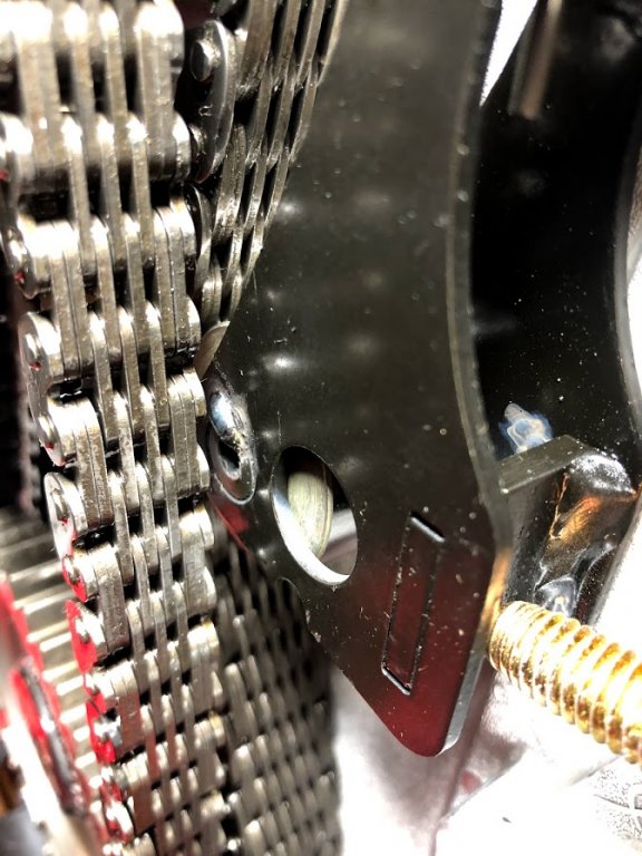

Chain Tensioner Roller Screws
I have posted in a separate thread, showing the roller screws coming loose causing me catastrophic failure. Ultimately ruining a trip and getting towed.
Thread here(ALL PICS OF ENTIRE INSTALL OF NEW CHAINCASE): Tensioner Roller FAIL
To avoid this, here is a SIMPLE CHEAP QUICK fix. When you have chaincase open, remove your tensioner/roller and have the two screws tack welded, be careful to keep the tacks small, so the rear tack does not rub/wedge against the rear of case(You can grind down the tacks if too large, so they dont rub).
I installed a brand new tensioner(warranteed) and before, I ground off a small section of paint on each side(screw/tensioner) to allow the tack weld to have a good connection.
Here is how it looks when tacked.
Dan
Dan

Dan does the part come with the roller? Was thinking to just pick up another to have tacked and ready once I pull it apart for lube change and cleaning.
ROCKERDAN
OCD Sledhead
- Oct 8, 2005
- 7,496
- 3,609
- 2,003
- Other
- '18 RTX 50th "Winder"
The part number i've shown is called the 'Holder'.Dan does the part come with the roller? Was thinking to just pick up another to have tacked and ready once I pull it apart for lube change and cleaning.
It all comes put together, and supposedly has loctite. But I dont trust it.
Dan

Thanks Dan, I'm just going to buy one and tack it and have it ready to install when I tear the chain case apart and then I will tack the original after I switch them out.
