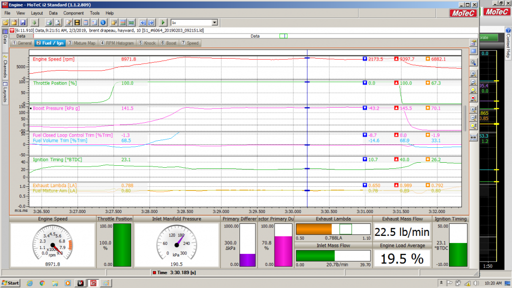

Thanks for the suggestion on PID control. My boost ramp holds within 6kpa of target and have full compliance with AIM within .5 seconds. Subtle adjustments to the Margin, I and D controls and it worked great. Thanks again!Have you watched to motec webinar about pid.
These are the three parameters the motec uses for boost control.
Another thing to look at that had a major effect on initial overboost is the margin setting, margin determins when the boost controller becomes active. If margin is set to close to aim it will cause a boost overshoot because the motec is late to the game and boost is already ramping up quicker than it can calculate where it needs to be.
Pid requires very small adjustments to the values. Fun stuff dialing these in
