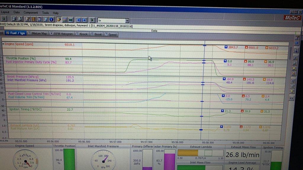

So this is the final tune on pump gas. Clutching struggles are finally fixed with the TAPP clutch. Here’s a pic of typical launch with the TAPP. Also included a log file to show how flat the shift RPM holds. Big props to Tommcat for a perfectly set up clutch. I bolted it on and this was the result.

So is that 20 psi boost with pump gas?

Hp estimated?

Yes 20 psi on pump gas. Based on injector duty cycle and and fuel pressure it’s about 360 hp.So is that 20 psi boost with pump gas?

So this is the final tune on pump gas. Clutching struggles are finally fixed with the TAPP clutch. Here’s a pic of typical launch with the TAPP. Also included a log file to show how flat the shift RPM holds. Big props to Tommcat for a perfectly set up clutch. I bolted it on and this was the result.View attachment 152316
Here are a couple logs from my stock turbo Precision EFI Stage 4 sled and MCX Winder with 19t Mitsu turbo and Motec. Both are on 91 pump and and PEFI runs 18psi with very aggressive timing and Motec is running lower timing at higher boost level. HP estimate on PEFI sled is 320 and MCX Motec is 340. Both are awesome sleds in their own right. Always nice to be able to log and analyze different setups.

Thanks for sharing. Very good logs. Both sleds look like they are running awesome! Great job on getting 250kpa on pump fuel. I’m done at 242. I have to pull too much timing with more boost. Ends up loosing rpm, i might have a slightly higher compression ratio? Are you running stock clutches?Here are a couple logs from my stock turbo Precision EFI Stage 4 sled and MCX Winder with 19t Mitsu turbo and Motec. Both are on 91 pump and and PEFI runs 18psi with very aggressive timing and Motec is running lower timing at higher boost level. HP estimate on PEFI sled is 320 and MCX Motec is 340. Both are awesome sleds in their own right. Always nice to be able to log and analyze different setups.

Stock clutches on PEFI sled and Tapp primary with stock secondary on Motec sled.
