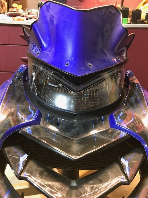

It was around $500 Canadian for the headlight and $50 for the wiring. So far it looks a lot brighter then my stock Viper headlight but I haven't had it out on the trail yet. Here are some pics and I will try to get more next weekend

I noticed that in the photos showing the headlight not lit, the retaining screws for the windshield are not installed. Did you need to fabricate a solution for the screw holes?

I have the Viper windy on my Sidewinder, so I think SR Viper just didn't get around to it....
The viper windy does fit the sidewinder, but the "wings" from the viper need to be trimmed. I would guess it is vise-verse for the Sidewinder windy on a viper.

Hey super1c, As you know I have both the Viper and Winder. The lighting (IMO) is better than the Viper. Would a kick but set up with HID's or LED's be the way to go? I'm thinking so if you want the best and brightest lighting out there.
I have white LED strips that I am going to try and duplicate the winder look on the Viper. I might even go blue LED strip lighting.
