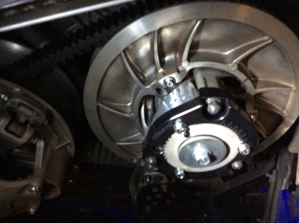

40G4313 Or 40C4313 gates is what I run in my 270 hp viper I change them out @ 2000 miles and they don't look terrible. I have a STM roller secondary with a 46-40 helix tho. The stock 35 helix in the winder seems like it might be 2 much. If I were you guys I would check my alignment and center 2 center, make sure there R no broken mounts or looseness in the motor, then give one of these belts a try. I was smoking 8jp's at around 800~1000 miles before I tried these belts. Clutches should be cool enough to grab with your hand and hold for as long as you want, any hotter and you have clutch issues. Hope this helps.
495 miles Bone stock..... belt dust and warm/hot secondary. flat spots on rollers, Original belt. Best run 117 speedo good conditions. no gps
Last 500 miles....Machined secondary, Thunder rollers,still original belt. 5 different people jumped on for consecutive 1 1/2+ mile out and back WFO back to back runs in 2" slush @ 104 GPS that i thought for sure would put that belt out of it's misery, but it survived.

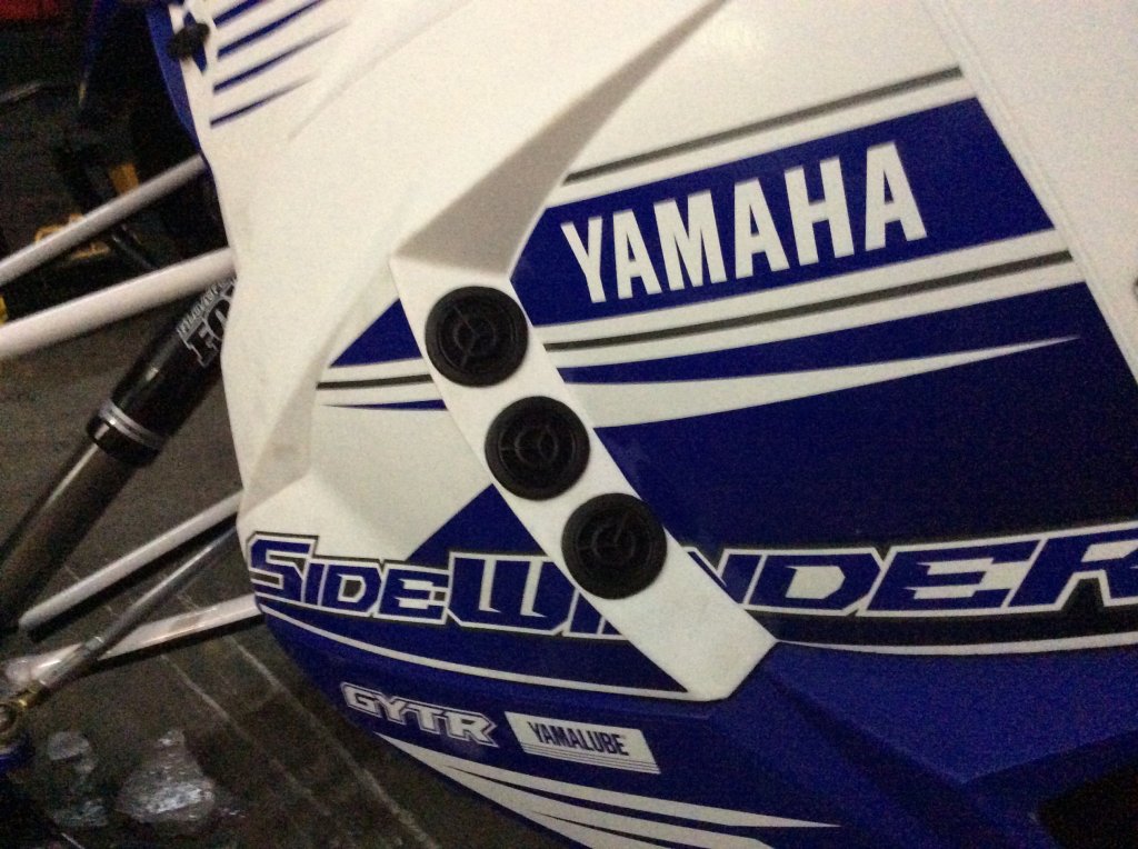

What vents are those clutch side?The stock helix is to shallow I use Gforce ajustable helix with 41/37 angle and for those that don t want to buy different weight, removed 3 g under the tip of the stock weights, your rpm will go up to about 8700 then slowly clim to 8800 to 8900 rpm and not over rev to 9000/9100 rpm than go back to 8800 rpm, that way your sled will stay at it s max hp and not loosing some time to over rev and go down to proper max rpm/hp.
