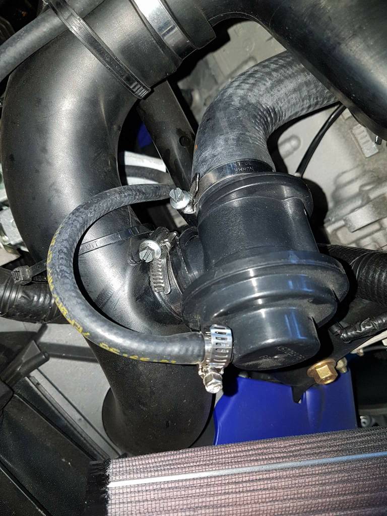

Reverse the blow off valve works great as shown on. Pic....Thanks for chiming in Dan, but I don't have the data logger, it's Max 17 all the time.
No data logger and no boost gauge. Swapping hoses on BOV.....do I simply unhook large hoses, turn BOV and re-attach opposite?? Where should I buy a good BOV and how much are they?

Did you get in on the boost leak tester PIF? My guess is the BOV or another leak.I believe I'm being haunted by a gremlin and would be interested in hearing input in developing a path forward in hopefully finding a cure. First a little history:
2017 Yamaha Sidewinder RTX SE with 2200 miles, bought brand new last winter, put TD Eco Trail Flash with a SQ muffler. For clutching I ran Dalton QAY-70 weights loaded with the 1 inch allen (4.1 grams) for a total of 74.1 grams. Springs/helix everything else stock except for updated torlon rollers in rear secondary. Sled would spin 9000-9100, once in a while if hot running is soft snow might drop to 8900. Sled ran flawless all winter and was a blast.
This year I loaded TD Max Pump 17 and also a CAI and OSP Racing muffler which is basically the same as a TD Turboforce. Per Ben's instructions I loaded Qay-70s to the hilt at 77.4. Would only spin 8300, so dropped weights a gram to 76.3, would spin 8400, dropped weights another gram to 75.4 and added stiffer secondary spring (TPI orange) and would spin 8700. Bear in mind, I know this thing isn't right so I'm holding it 4-5 seconds and letting go as it doesn't feel right. In my head I'm thinking the sled feels no different than last year and my butt dyno is telling that this thing isn't making the claimed 285 hp as it should.
So this morning I figured I'd go back to basics and eliminate some variables. I set sled up just like I had it last winter, SQ muffler, stock airbox, Dalton weights loaded to 74.1 grams, stock springs and stock helix. Took sled out for some testing and assumed this thing should be banging off the rev limiter!! To my dismay, would only pull 8700 rpm. It's turning 3-400 rpm less than last years Eco trail????? WTF??? I'm making less power???
So......I'm thinking I must have a boost leak. I removed all the panels, checked......double checked... and then triple checked all the hoses, clamps, air box, intercooler, and can't seem to find anything out of the ordinary. I was thinking perhaps the BOV crapped out so I removed it, checked the plunger and all looks legit. I pushed on the spring valve and it needed a very healthy push with my thumb to get it to open.....so I'm thinking this looks to be sufficient also.
I could take it to the dealer, but he'll blame it on the tune. Does anyone have any ideas on where I should go next?

Gentleman, first and foremost, thank you for your time and attention in this matter. I really appreciate the help.
Hadn't seen the family in over a week so spent the day with them......but this issue was eating at me all day. This evening I snuck out to the garage, swapped the BOV around, and headed out for some testing only to get more discouraged. Initially still would only turn 8700. Then twice, it went to 8700 at full whack, fell to 8350 and then slowly made its way back up to 8700. I thought WTF.....held it for a third pull. Once again, it lit up at 8700 and fell to 8350, but then sled started to miss and flames came out the muffler. Babied it home and parked it. Surprisingly, zero to half throttle in the trails it still runs well!!
So...I'm guessing nothing wrong with BOV. Did some hunting on this site and I was able to locate the boost PSI tester from Beerman. Sent Sidehogger a pm to get on the list. If and when I receive it, I guess the next step is to test for boost leaks elsewhere!!
Any other ideas?
Any other ideas?
Any other ideas?
