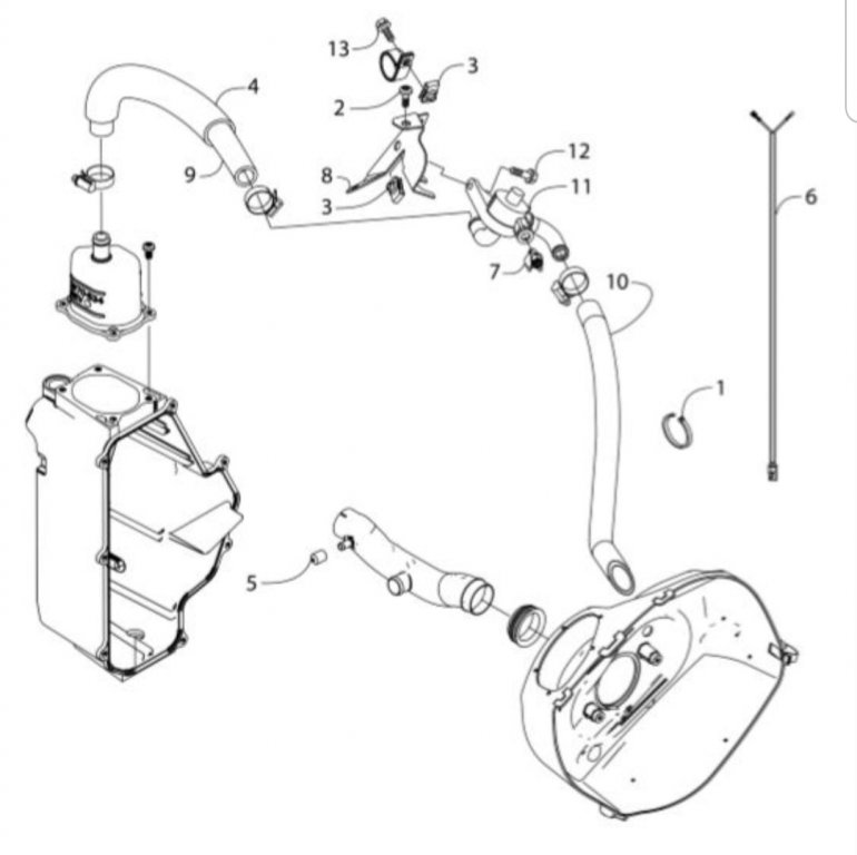

Hey TT,is part number you listed actually a kit which includes valve/heater /wiring?I typed in part # and only comes up on partzilla but no listing of what is included.thanks

My dealer contacted Yamaha and they said they do not have a retro kit for the 17-19 sidewinder ROV.

All you need to do is remove everything above oil tank and install new roll over valve, run hose from tank to valve and another hose from valve to anywhere but the air box lol, add power to the new valve so it heats up on start up and you are done..My dealer contacted Yamaha and they said they do not have a retro kit for the 17-19 sidewinder ROV.
To my understanding it i a complete kit. Arctic Cat also has a part # for a complete kit to convert pre 2020 sleds ro the updated heated ROV. AC part # is 0637-533
Arctic Cat also has a part # 0637-533 for a kit. I have ordered it from Country Cat.Hey TT,is part number you listed actually a kit which includes valve/heater /wiring?I typed in part # and only comes up on partzilla but no listing of what is included.thanks
It is a kit that supposedly include parts from 1-13 in the picture
I hope you are not correct. I have contaced a local dealer i Norway, Europe to see if they have any information from Yamaha Norway.My dealer contacted Yamaha and they said they do not have a retro kit for the 17-19 sidewinder ROV.

Number 10 is a bad idea lol..Arctic Cat also has a part # 0637-533 for a kit. I have ordered it from Country Cat.
It is a kit that supposedly include parts from 1-13 in the picture View attachment 152458
I wish they just had a catch can instead of dumping it to the intake. A working ROV setup is needed in the mountains or while boondockingNumber 10 is a bad idea lol..
