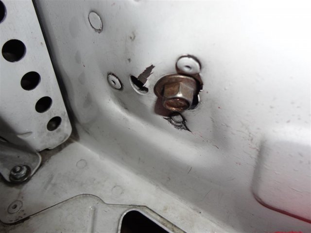

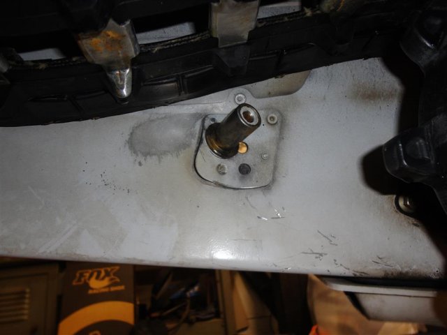

All Viper Owners take a look at your front arm cross shaft on your rear skid. Especially if you are riding these sled super aggressively over heavy rutted trail trash. It looks like the shaft is shearing off right at the end of the bolt and the bushing support. It looks as if most of the damage is done to the shaft and the tunnel once it lets go.
View attachment 106821 View attachment 106822 View attachment 106823 View attachment 106824
The bolt and collar should not be the same length so the stress on the shaft is not in the same place... thats my take on it.
See the skid looks fine.
Im scratching my head at this issue as well. 9000km/5600mi on my chassis. I had the H frame go the brackets go at the upper idler and now this issue all at different times. Not sure if my shock froze up and when the weight transferred up in the trail chatter it sheared the cross shaft this time?? Next sled will definitely be upgraded to a RR/LE or just wait till Yamaha parts ways with the dated pro cross chassis. I think as Yamaha riders we all can agree we demand more.

I'll add this to my pre/post check list.All Viper Owners take a look at your front arm cross shaft on your rear skid. Especially if you are riding these sled super aggressively over heavy rutted trail trash. It looks like the shaft is shearing off right at the end of the bolt and the bushing support. It looks as if most of the damage is done to the shaft and the tunnel once it lets go.
