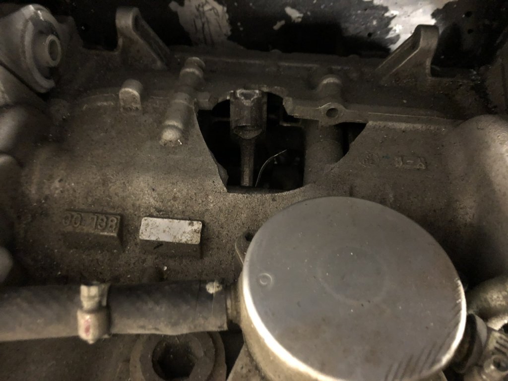

Here is a pic of the parts motor I’m using for fit up of exhaust and motor mounts.
I wish I had a apex motor to put in here I love the sound of them and the power is impressive. But there is not many of them in my area and the price of them is still fairly high.
