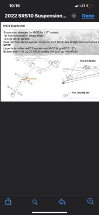

The rear suspension on the front arm has some differences also, I think Hammer70 converted his sled to the newer version.
