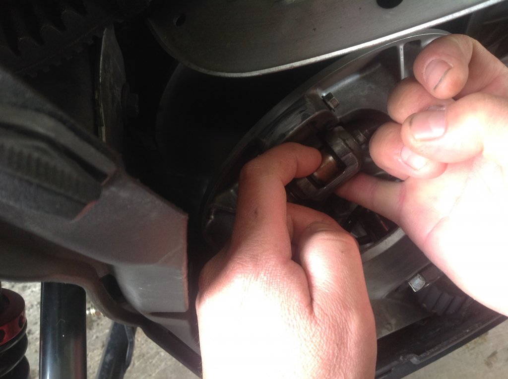

This is the best way to chek for play on the pin, i am doing it so many time that my nails are tattooed
Chek for bushing slip,they ALWAYS slip clockwise looking at the clutch. If the right washer on the roller show sing of worn, your primary weight bushing are MORE than shut to.

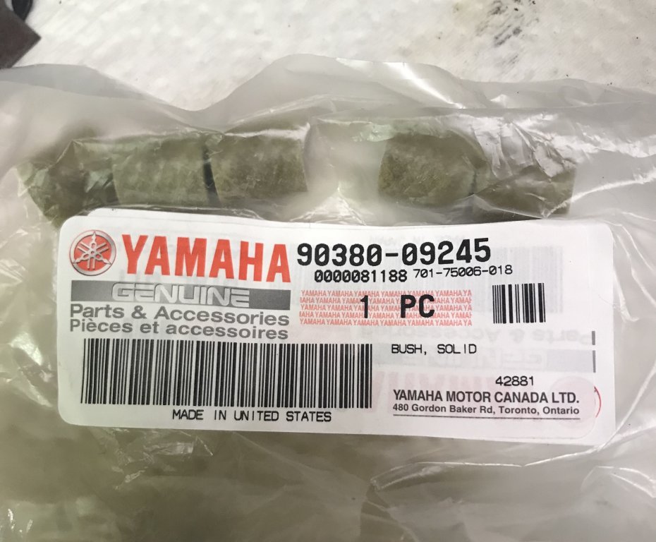

Change your rollers and belt every 1000miles with tunes , and buy duralon bushings , and a quick daily check of rollers play not bad to have 290 hp sleds
Are these bushings what the aftermarket guys are using?
'Cuz they wear also, just not as quick.

They look the same ... lolAre these bushings what the aftermarket guys are using?
Yes they wear but it’s a lot better . I haven’t had one slide over in the roller yet , which speeds up the wear when the roller jams.

Our bushings are Duralon bushings in our rollers.
